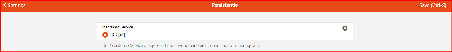

I ticked off ‘rrd4j’ as default persistance ‘tracker’:

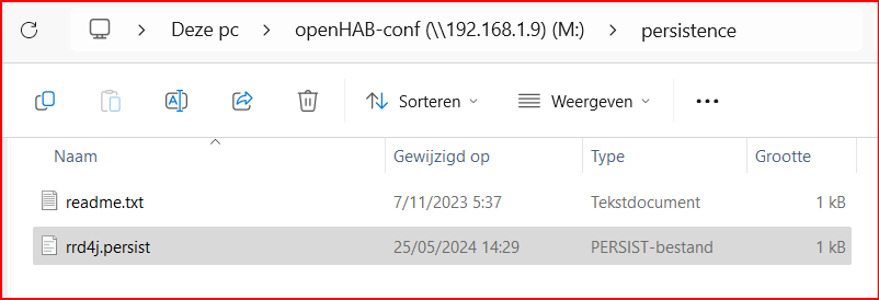

I created rrd4j.persist in the correct folder:

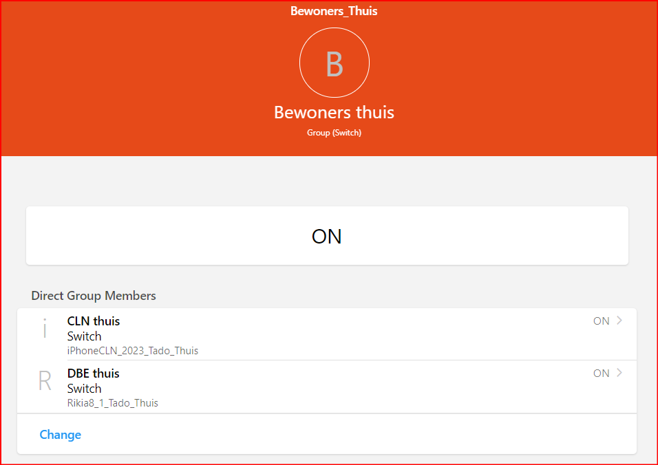

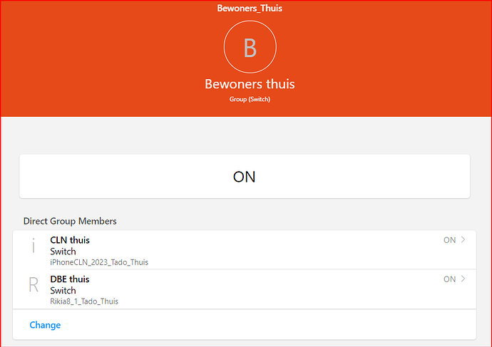

Bewoners_Thuis is a group containing the two Items linked to the channels of our mobiledevice Things:

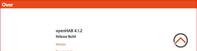

Which openHAB version do you use?

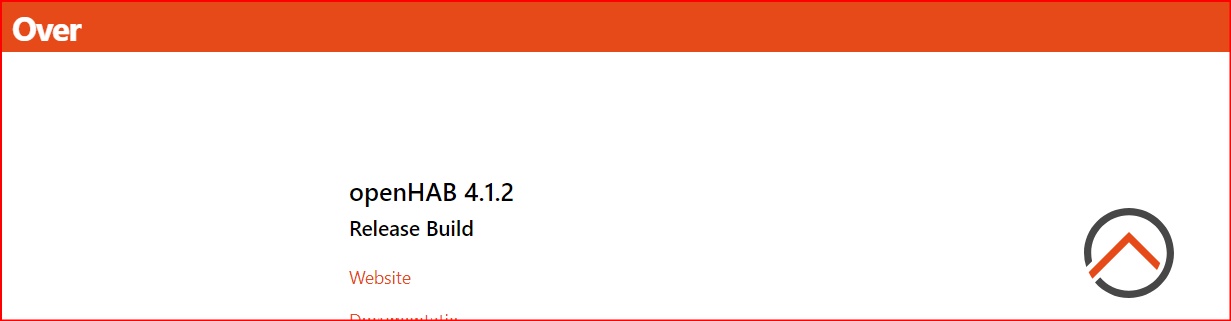

The output is 4.7.3.
As you are using openHAB 4.1.2, you cannot use Item::persistence.
It is Item::history instead, just have a look at the docs: JavaScript Scripting - Automation | openHAB
