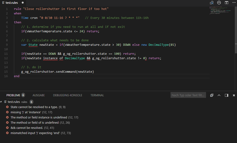

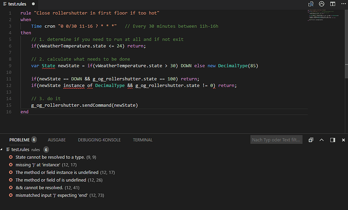

Hi Rich, thanks a lot for your input. I do see the advantages of using your strategy which is clearly superior.
However, I am struggling a bit when using your code (copy & paste). Using VS Code, I get a number of errors.
Also, would you mind to elaborate a bit on the syntax?

Hmm. All the errors are related to the same problem. I guess State isn’t available. Try replacing State with Command.
var Command newState = if(vWeatherTemperature.state > 30) DOWN
If that doesn’t work try removing the type entirely.
var newState = if(vWeatherTemperature.state > 30) DOWN
If that doesn’t work try using 100 instead of DOWN.
var DecimalType newState = if(vWeatherTemperature.state > 30) 100
Or perhaps it needs to be a PercentType.

This line of code is producing error messages no matter which of your suggestions are used. I now tried the following solution, but I am not sure if this is all programmatically correct.
