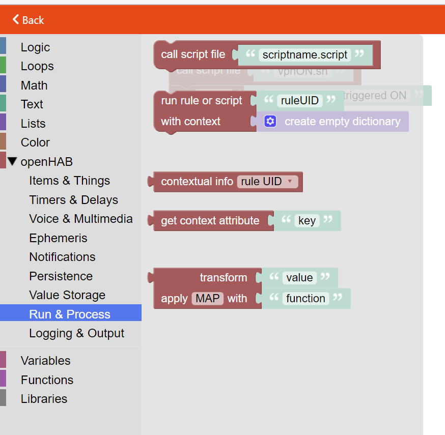

I did not find it an assume it shoulb be here:
Another solution, which I had to resolve to when coming to OH3 from OH2 (because callScript was broken there for a while) was to put the contents of my (DSL) scripts into (DSL) rules and just postUpdate a virtual Switch item to trigger them instead. That will always work.
I may be mistaken and it’s planned to be added. So much new stuff was added recently it’s hard to keep up.
No problem - I am still always impressed what you have on top of your head :slight_smile: I will check out @OMR suggestion then.
