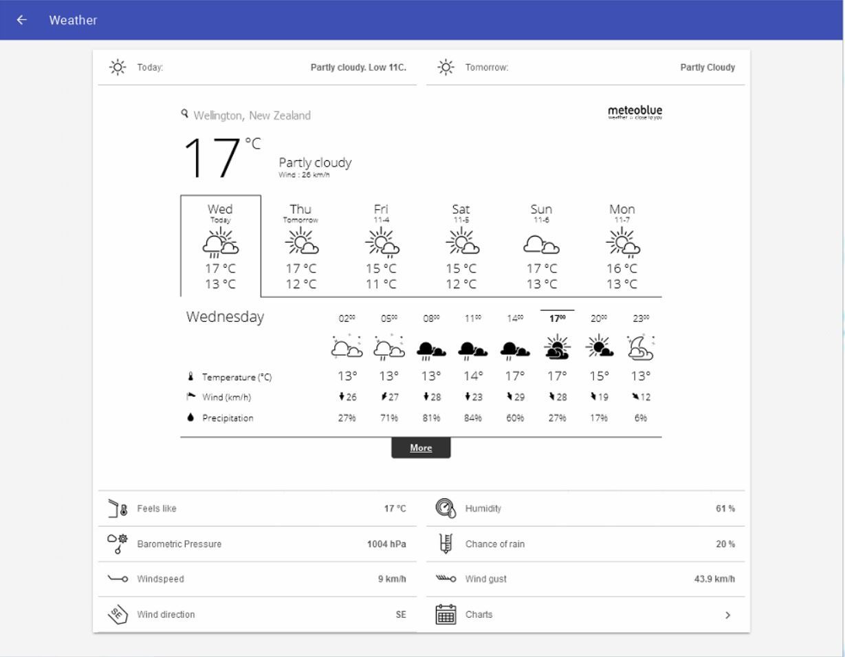

In the image below I still have data being pulled from the weather binding (wunderground) being displayed. There will no doubt be variance in the content but this is something I probably don’t care too much about when using the weather webview in a different location in the sitemap.

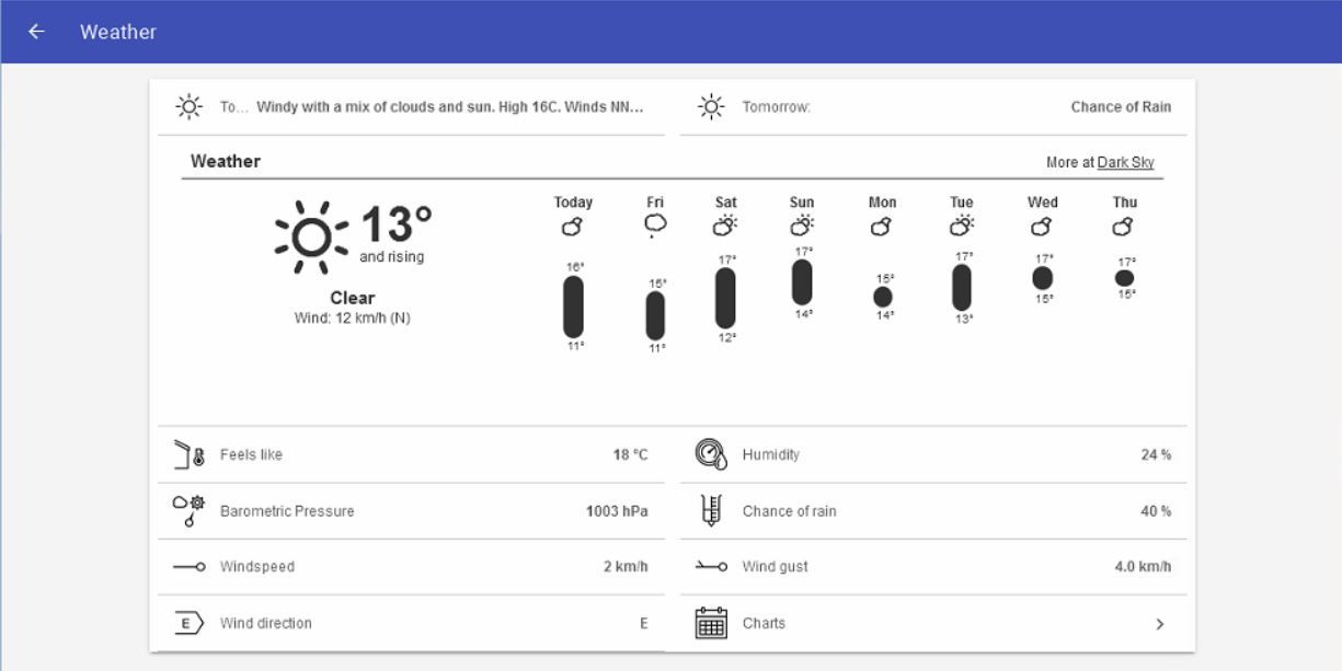

Here’s what forecastio/DarkSky looks like:
Using:
<!DOCTYPE html>
<html>
<head>
<meta http-equiv=”Content-type” CONTENT=”text/html; charset=utf-8″>
</head><body id=”weather-body” onload=”formatIframe()”>
<tr>
  <iframe id="forecast_embed" type="text/html" frameborder="0" height="245" width="100%" src="http://forecast.io/embed/#lat=-41.2865&lon=174.7762&name=Wellington color=#00aaff&font=Arial&units=ca"> </iframe>
</tr>
</body>
Note: The icons on this iframe are animated so are quite nice to look at.
