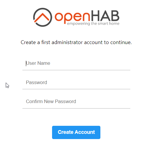

Hi @Udo_Hartmann , thanks for the suggestion, I’m aware about the way of adding users/api keys etc via karaf, the problem is, that during init scripts karaf is not yet running and on the first run jsondb/users.json doesn’t exist yet.
to get jsondb/users.json created, you still need to run initial setup via UI and I’d prefer to get it configured without a single manual interaction, so even I would be able to properly hash and salt the password, it wouldn’t still be in use before manual init setup via UI.

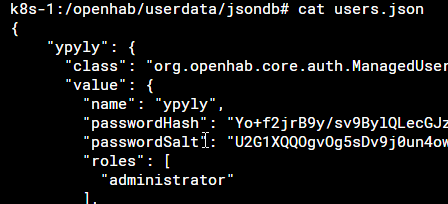

thanx for the suggestion, however openhab fully ignores users.json, until first user is created via UI.
Just tried it once again:
  1. Freshly installed openhab
  2. users in-place:
  3. users are not present in karaf (and not able to do anything)
