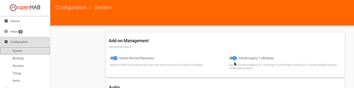

Can you Elaborate, how I install the Astro 1.x action?
Within PaperUI I only see Astro under “Add-ons / Bindings” as binding-astro_2.5.0.
But I don’t see any action-astro.
Enable 1.x addons in addons.cfg or Paper UI…
Wow, sometimes it is just so easy.
Thanks a lot!!!
