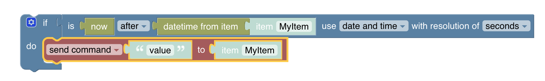

There it is, 7th from the top. Now I want to compare now with the state of a DateTime Item and only if it’s later send the command. That’s a comparison so let’s look under “Logic” and I see blocks for an if statement and comparisons. But it’s not clear how to do DateTime comparisons. Let’s look under Dates & Times and there I see now and some date time comparison operation blocks.
It’s not zero knowledge but it avoids the dreaded blank page problem. And if you want to see the syntax click the code icon at the bottom.

if (zdtCompare((time.ZonedDateTime.now()), (time.toZDT(items.getItem('MyItem'))), 'after', 'seconds', 'dateandtime')) {
  items.getItem('MyItem').sendCommand('value');
DateTimes are complicated so that probably wasn’t the best demonstration. But I think you get the point. It’s not zero knowledge by any means. You have to know what core concepts are in OH to know where to look. But just seeing the choices goes a long way towards helping you get going.
