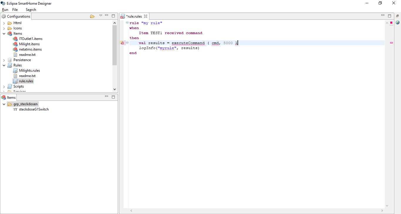

Some mention form me: At the moment i have create only items - should I create also Things? How schould them looks like?

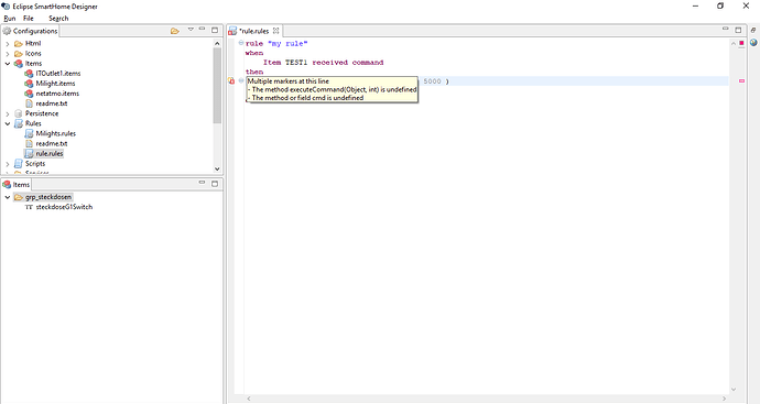

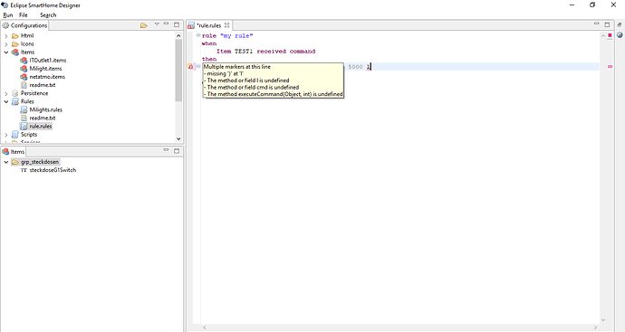

val results = executeCommandLine("/opt/raspberry-remote/steuerung1@@1", 5*1000)
instead of
val results = executeCommand( cmd, 5000 l
line. Make sure you have the EXEC binding installed.

I took a look to the directory openhab2-logs/openhab.log there is a warning:
2017-06-04 15:43:28.554 [WARN ] [hab.binding.exec.handler.ExecHandler] - Couldn’t transform response because transformationService of type ‘REGEX’ is unavailable
Can this help to solve my problem or where can i find the result uf the rule?
loginfo line should write the result in opanhab.log. However maybe you should also install REGEX Transformation from paper ui-addons-transformations page as exec binding seems to have a dependency on regex transformation.
