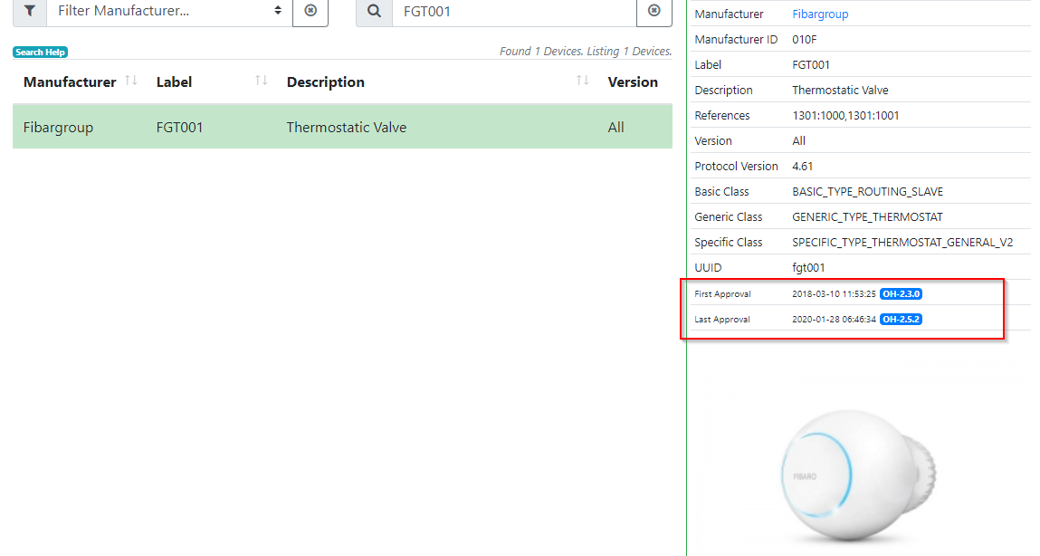

What version of openHAB? The current database information should be in version 2.5.2 or later.
If the Thing was added before that version, you need to delete the Thing (NOT exclude from the network) and rediscover / reinclude it to get the latest settings. It will gave the same ThingID so your Items do not break.
It is also possible new features were added with newer firmware and a new database entry needs to be created.

You are very welcome. One feature I like with then new database site is it tells you what OH version a device was first added and what version has the latest update.
