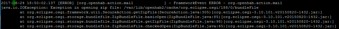

Hi guys
It is a week that I try to use action mail 1.9.0 (using openhabian), but it never works.
In a first time I thought it was why I have a two factor authentication on gmail, so I changed the mail server, but in the log I find always the previous gmail server. I uninstalled action-mail, I deleted the mail.cfg, afterwards I edited the fresh mail.cfg, but it seems that the system does not read the new cfg. Change of the port/tls has no effect. Any help?
shutdown OH2, clear /var/lib/openhab2/cache & /var/lib/openhab2/tmp, start OH2
Also, remove /var/lib/openhab2/config/org/openhab/mail.config before restart to be sure…
Fix your /etc/openhab2/services/mail.cfg as in example below:
ls -al /var/lib/openhab2/ please
it seems that the permissions are not correct for the tmp folder (can’t write the lock file)
did you change the ownership of the tmp folder after you created it?
(to avoid typing sudo all the time with the openhabian user, switch permanently to root using: sudo su)
When you will start up OH2 again, the service will re-populate the cache and tmp directories with the proper content and you will not have any problems.
If this doesn’t work, re-install the mail action from PaperUI.
Thanks for your reply but it seems the rm commands have broken my system way beyond that. I have followed the post #11 steps but still have issues.
The exec binding was broken but a re-install thru PaperUI fixed that.
The mqtt binding is not working after two re-installs thru PaperUI. I then tried uninstalling the mqtt binding and then re-starting OH2 before again re-installing. It is like mqtt is not installed looking at the logs. I will set logging to DEBUG and report further.
