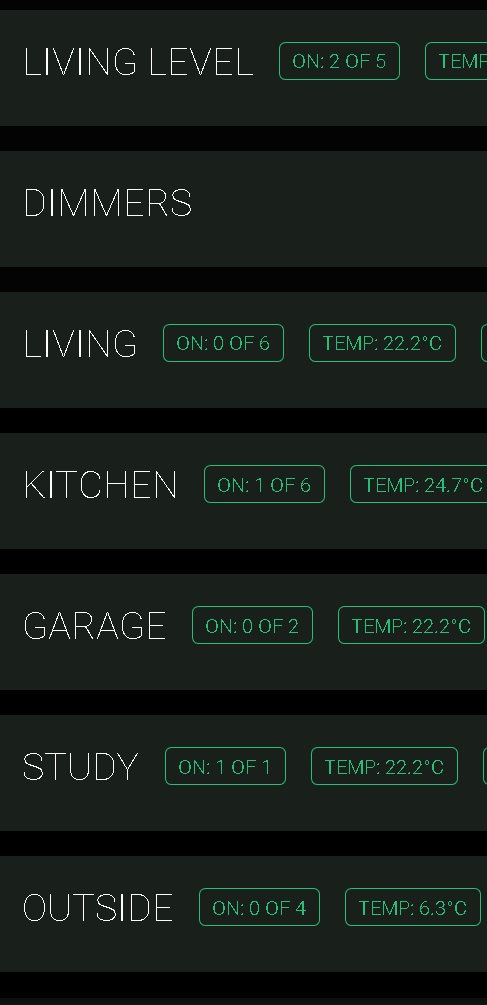

18
I Spoke too soon!
Combined number is 19 lights on this Living Level, yet the parent shows only 2 of 5.
2 on is correct , 1 in Kitchen and 1 in the study. But who knows where 5 is coming from!
Group:Number:SUM gAllLivingLights "All Living Lights [%d]"
/*Group Definitions for Lights on the Living Level*/
Group:Switch:SUM gLivingLights "Living Lights" (gAllLivingLights,gInsideLights,gAllLights) [ "Lighting" ]
And displayed with:
div ng-repeat="item in itemsInGroup('gAllLivingLights') | filter:query as filteredAllLivingLights"></div>
<div class="summary on">ON: {{ ( filteredAllLivingLights | filter: { state: 'ON' } ).length }} of {{filteredAllLivingLights.length}}</div>
rossko57
(Rossko57)
August 15, 2019, 10:21pm
19
It’s got five direct members (the groups).
dastrix80
(Kris K)
August 15, 2019, 10:24pm
20
Which is not what I wanted in the original post.
What I want to display, is the number of lights ON inside that parent group.
Not the number of groups in the parent…
