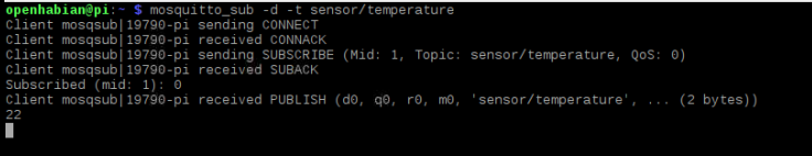

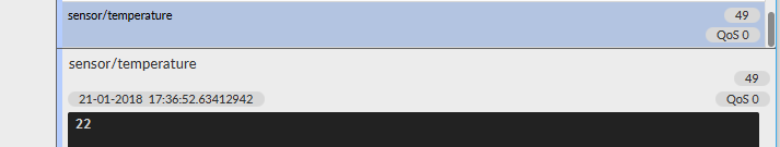

I corrected the wrong code loading here. I can read the Mqttfix temperature data.
Where am I doing wrong?

I checked everything. showing down in the picture. I can not just show OH2.

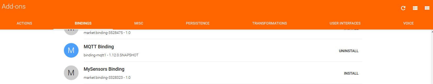

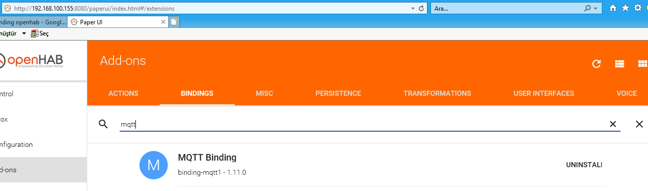

From the earlier posts your setup looks quite right, so did you install the MQTT binding at all?

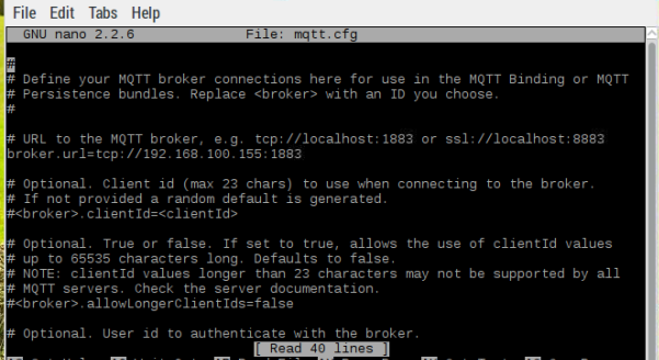

it is very interesting. I practiced the ensemble below.
broker.url=tcp://localhost:1883
broker.clientId=openHab
broker.qos=1
If you are playing around with the mqtt cfg file a lot you may be affected by a bug (wrong content of config could be cached):
check your /var/lib/openhab2/config/org/openhab/mqtt.config file if it has the same content as your mqtt.cfg.
If not, delete the mqtt.config and restart openHAB. The file will be recreated with the correct content and mqtt should work.
