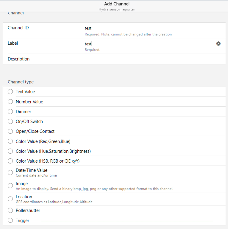

When creating the Channel, “Trigger” is among the types.
And the channelTypeUID is set to mqtt:trigger instead of there being a separate configuration parameter.
