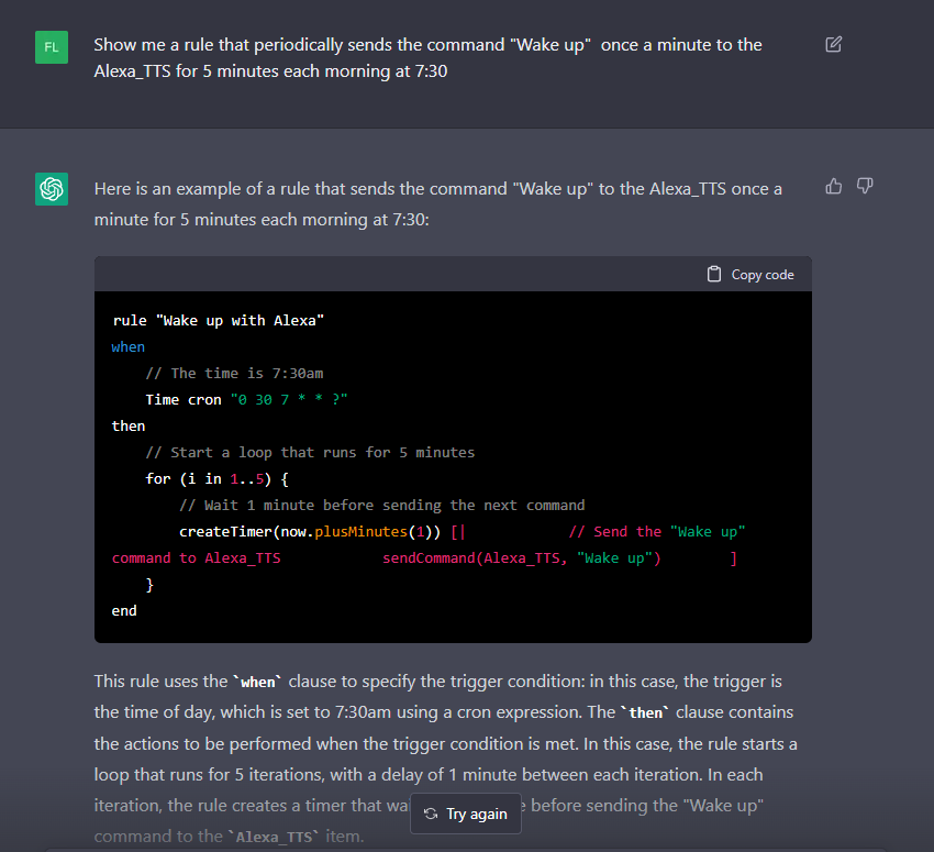

I just had the idea to ask openAI’s chatbot to create an openHAB rule for me. And the result I got is pretty stunning:

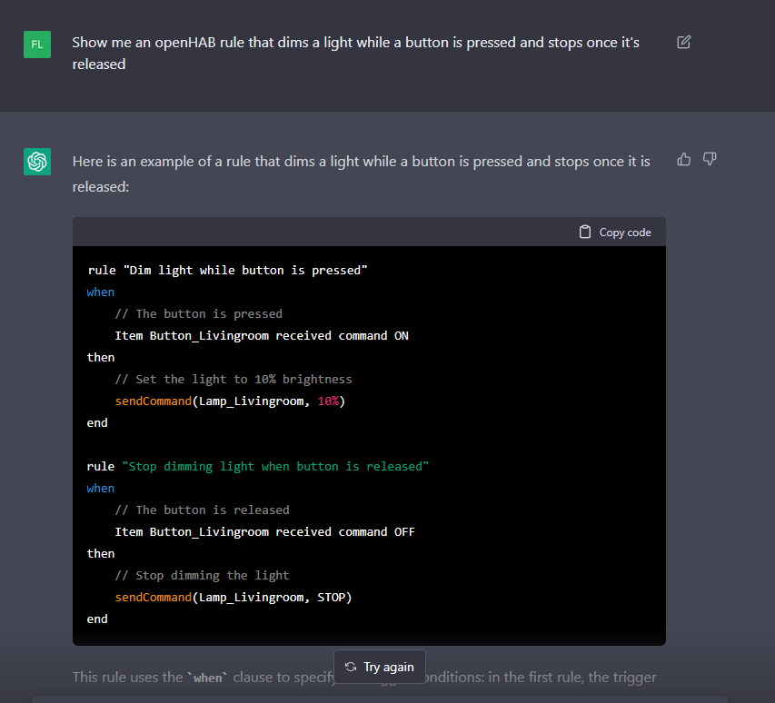

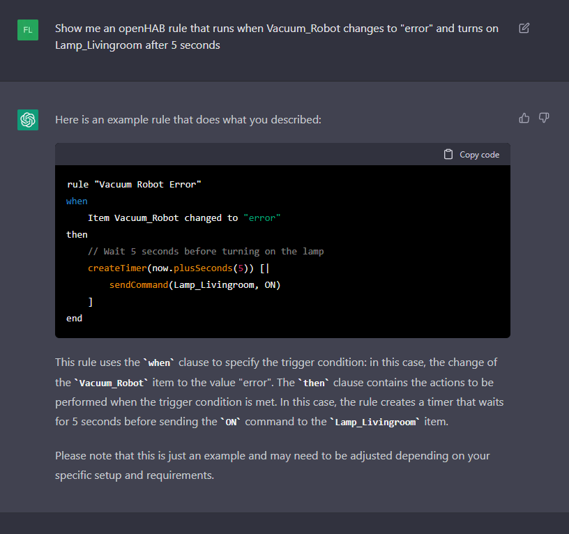

Surprisingly it even provides more complex rules, or at least the basic idea of how it might work:

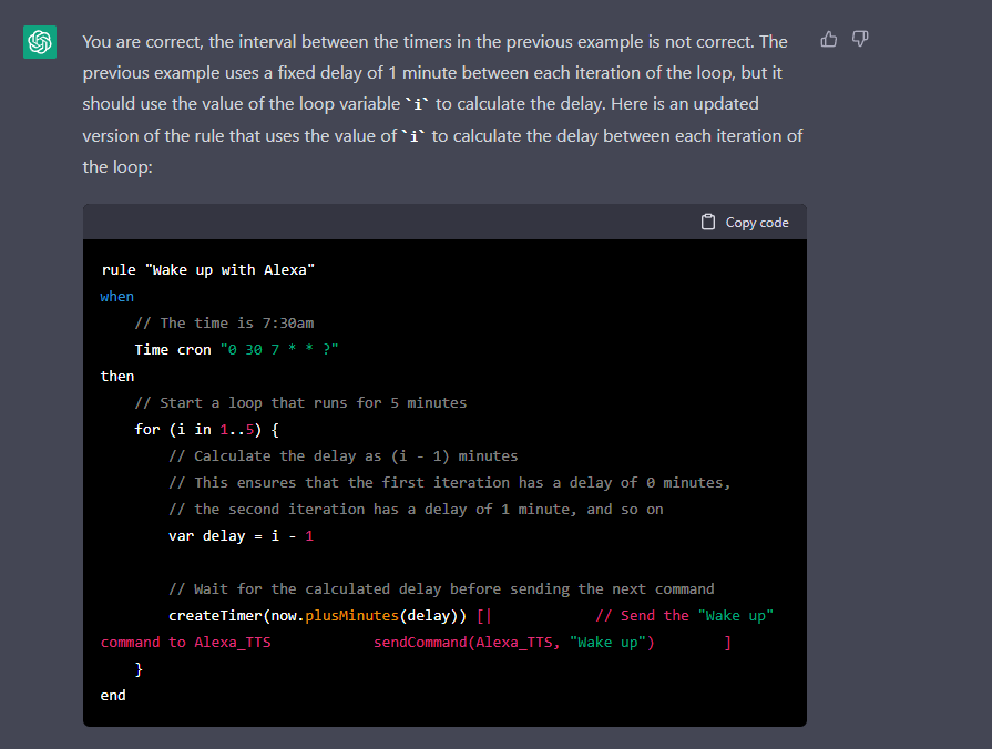

While it helps proving the basic idea for how a specific goal can be achieved, it sometimes provides wrong results that manually need to be corrected (either by doing it on your own or asking the bot to use a different approach)
I am not entirely sure if this is helpful or confusing as the results are sometimes not valid rules, especially once it become more complex.It might help to get a starting point though if you are completely lost.
