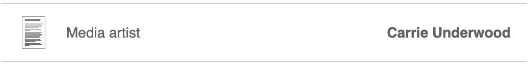

I want it to look like this but cant get the state to show on the right side where Carrie Underwood is:
Thoughts and advice is appreciated.

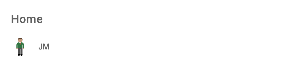

Here is a screenshot of my sitemap with this implemented
for those not aware, the visibility tag above basically hides the ‘incorrect’ item according to how JMHomekit is set. When JMHomekit is on, the item JMsAway is hidden but JMsHome is shown and visa versa.
