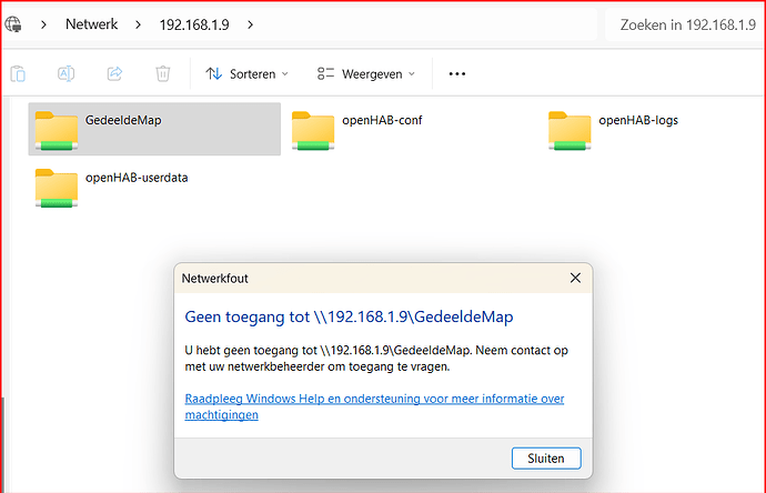

But no:
(I apparently don’t have access…)

You did
chown -hR openhab:openhab /home/erik/Openbaar
but what is the permission of /home/erik ? Is it (r,) x for others ?
erik@MinipcLG2:/home$ ls -pal
totaal 24
drwxr-xr-x  4 root root  4096 nov 21 15:12 ./
drwxr-xr-x 25 root root  4096 sep  6 06:19 ../
drwxr-xr-x  3 root root  4096 nov 17  2023 .ecryptfs/
drwx------ 27 erik erik 12288 nov 21 15:25 erik/
Maybe there’s a better place for this shared folder?
try if
chmod o+x /home/erik
solves the problem.
With that configuration one need to know file/directory names inside of /home/erik to find them.
Hooray! Thanks!
