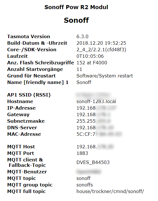

Based on the tutorial from Sven, I was able to convert the MQTT setup for the Sonoff devices using the firmware from Theo Arends: https://github.com/arendst/Sonoff-Tasmota
When combining the definitions of the bridge and things in one file, the system did behave quite strange. Things were not updated or I had to rename the broker. Accordingly I moved the definition of the bridge in a separate file.

As David stated, there are different firmwares for sonoff. A tools like MQTT.fx will help to see the topics and messages.
Sorry, I wrote misunderstanable. My little zoo of Sonoff devices (Sonoff Basic, Sonoff 20, …) are all flashed with the Tasmota firmware, version 6.3.0.

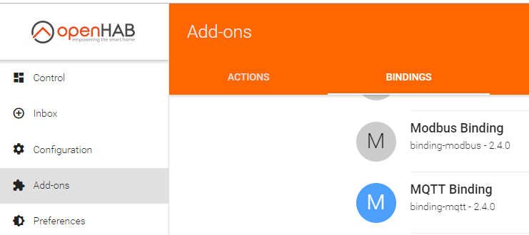

I have a doubt: if you write the .things and .items file, do I need to install the MQTT 2.4 binding??
I flash them without soldering any pin heads. I just make sure the four male wires are connected under an angle and it flashes perfectly. Did it now with five devices, 100% first time right. Just a thought.
@paulo9999:
You do need to install the binding first. The .things and .items are using the binding, not replacing it.
Open PaperUI and add the binding as shown below

HI All,
I’m trying to use MQTT with a sonoff but I’m not able to make it work.
I’m running OH2.4 on RBPI and have set up the
then I have set up the
my things file is the following:
Bridge mqtt:broker:myMQTTBroker [ host="192.168.2.105", secure=false, username="XXXXXXX", password="XXXXXXXX" ]
    Thing mqtt:topic:sonoff_sw01 {
    Channels:
        Type switch : switch [ stateTopic="stat/sonoff_sw01/POWER", commandTopic="stat/sonoff_sw01/cmd/POWER", transformationPattern="JSONPATH:$.POWER", on="ON", off="OFF" ]
my items file is the following:
Switch swScaldasalvietteP1_Switch "Scaldasalviette P1"  { channel="mqtt:topic:sonoff_sw01:switch" }
I get the following line in the log which tells me that the broker is online
mqtt:topic:sonoff_sw01' changed from OFFLINE (BRIDGE_OFFLINE) to ONLINE
I get the following line in the console of the sonoff which tells me that it connected to the broker:
19:00:49 MQT: Attempting connection...
19:00:49 MQT: Connected
but when I switch ON/OFF the sonoff I get nothing in openHAB. Also, switching the item ON/OFF via HABPanel nothing happens to the sonoff.
Any help? Did I write well the things and items files?
