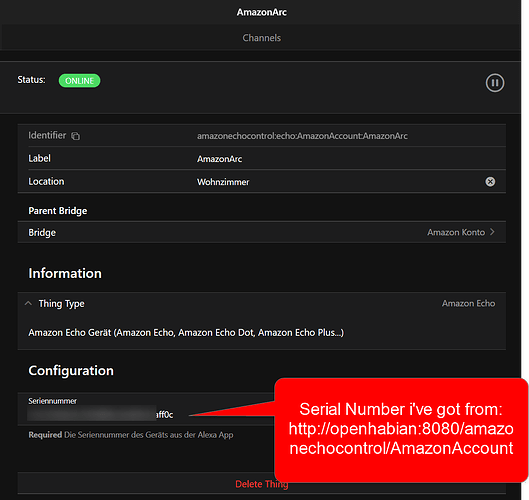

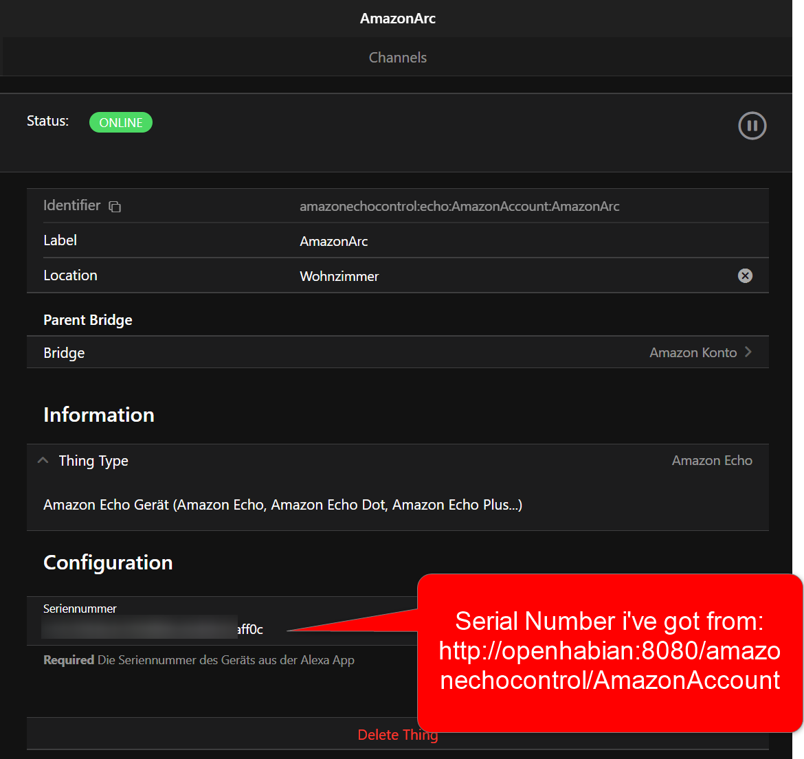

Let me explain the configuration of the Sonos Arc as Echo Device: I Installed the Amazon Echo Control Binding.
And I grapped the serial number of my Arc here.
http://openhabian:8080/amazonechocontrol/AmazonAccount
After that I manually added an Amazon echo device.

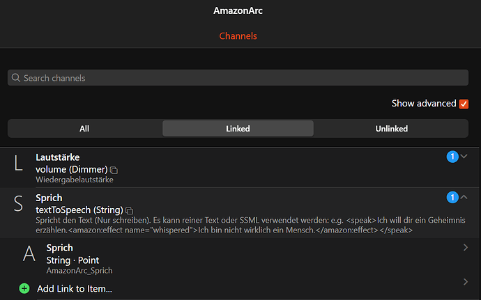

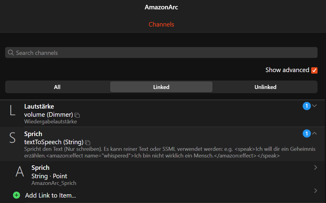

And here the channel linked to the Item “AmazonArc_Sprich”
And the following ECMA Script works fine, with an perfect amazon voice (neural quality)
items.getItem("AmazonArc_Sprich").sendCommand("<speak> <voice language=\"en-AU\">Hello World </voice> </speak> ");

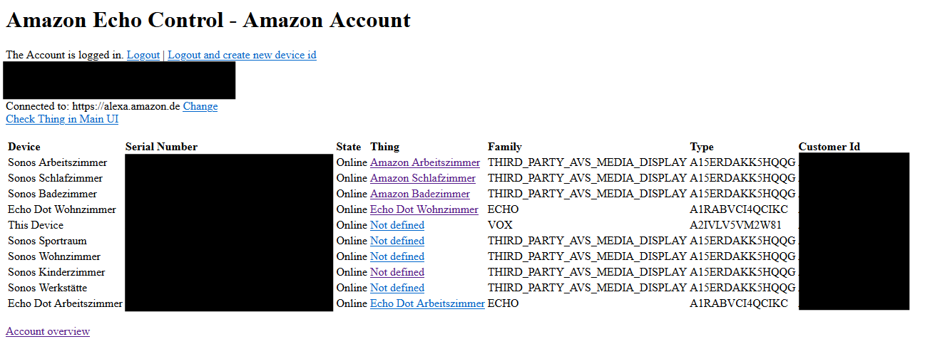

I looked at this a bit further. I can actually control all my Sonos (Amps, Ones and a Beam) via the Echo binding as music player, so in principle the connection seems to work, only the speak channel does not.
When looking at the Sonos devices in the Amazon Echo Control page (http://<My openHAB IP>:8080/amazonechocontrol), they are listed as THIRD_PARTY_AVS_MEDIA_DISPLAY, and when clicking on the link in the Thing column, under Capabilities they do not have ALEXA_VOICE listed. For our Echo Dot devices ALEXA_VOICE is listed and for them also the speak command works.
How does this look like in your system?
that was a good hint. Each Sonos Speaker appears as two different devices in the device overview.
And i seems as the “Family” is the crucial point
THIRD_PARTY_AVS_SONOS_BOOTLEG → TextToSpeech does work
THIRD_PARTY_AVS_MEDIA_DISPLAY → TextToSpeech doesn`t work
I don´t no why there are two devices, it must be something within the alexa app. I´m going to investigate that at the weekend.
Here an example. Both marked lines are the same Sonos One Speaker.

To get the BOOTLEG devices I removed the Alexa voice assistant in the Sonos app, removed the devices in the Alexa app, then re-added the Alexa voice assistant in the Sonos app and with that got everything back in the Alex app. Now for all Sonos devices that have Alexa enabled I also got two devices in the Amazon Echo Control page, one with family “THIRD_PARTY_AVS_MEDIA_DISPLAY” and another with “THIRD_PARTY_AVS_SONOS_BOOTLEG”.
And for the Things created with the serial number of the “THIRD_PARTY_AVS_SONOS_BOOTLEG” device, the speak channel now works. In my case this are Sonos Ones (2nd generation) and a Sonos Beam. @ML1982, have you in the meantime been able to get it to work on your Ones?

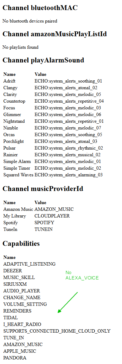

What does not work is use Sonos devices that do not support Alexa because of the lack of microphone, such as the Amp or One SL. For those there is no “THIRD_PARTY_AVS_SONOS_BOOTLEG” device with the ALEXA_VOICE capability that seems to be needed for the speak channel to work.
