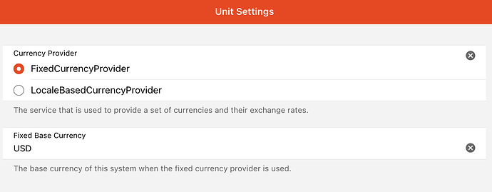

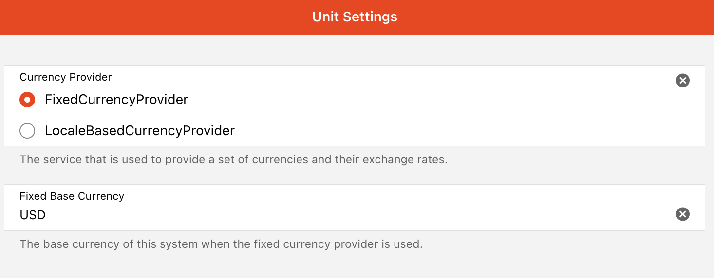

  1. Navigate to Settings and under “System Settings” click on “Unit Settings”.
  2. Choose the desired provider and if choosing “FixedCurrencyProvider” supply the default unit.

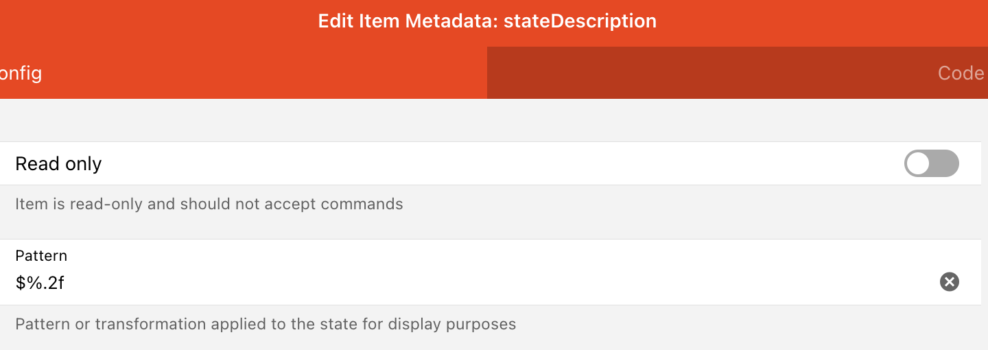

Number:Currency
This Item represents an amount of money. Define the Item as a Number:Currency. As with other units the default representation will be a floating point number followed by the unit, for example 123.456789 $. Therefore you’ll want to configure the State Description pattern to only show two decimal places and show the unit in front of the number (if that’s how it’s usually done for your currency of support).
value: " "
  pattern: $%.2f

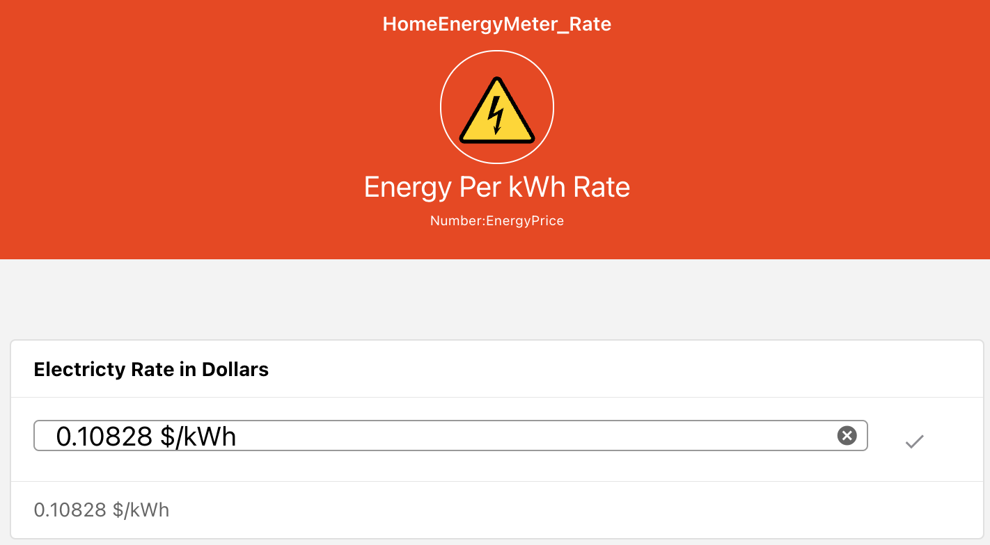

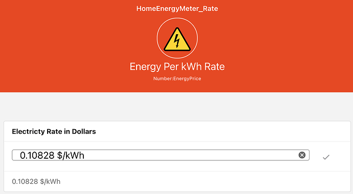

Number:EnergyPrice
This type of Item represents the amount of cost per kWh of energy (other per unit cost situations like per gallon/liter are not yet supported). The unit for this Item is going to be DEF/kWh where DEF gets replaced by the provider with your configure currency.

Here I’ll show a simple example of calculating using these Item that takes the monthly energy reading and calculates the monthly bill based on the access rate and per kWh rate.
The Items
Number:Energy      HomeEnergyMeter_ElectricmeterkWh
Number:Currency    HomeEnergyMeter_Access
Number:EnergyPrice HomeEnergyMeter_Rate
Number:Currency    HomeEnergyMeter_CurrentBillEstimate
The first comes from a power meter (a Zwave whole house energy sensor in my case). The second two come from my power bill and are set manually. The last one is the result of the calculation.

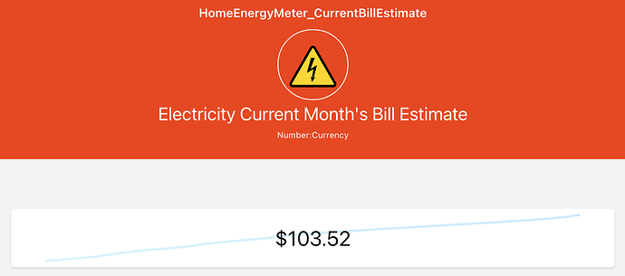

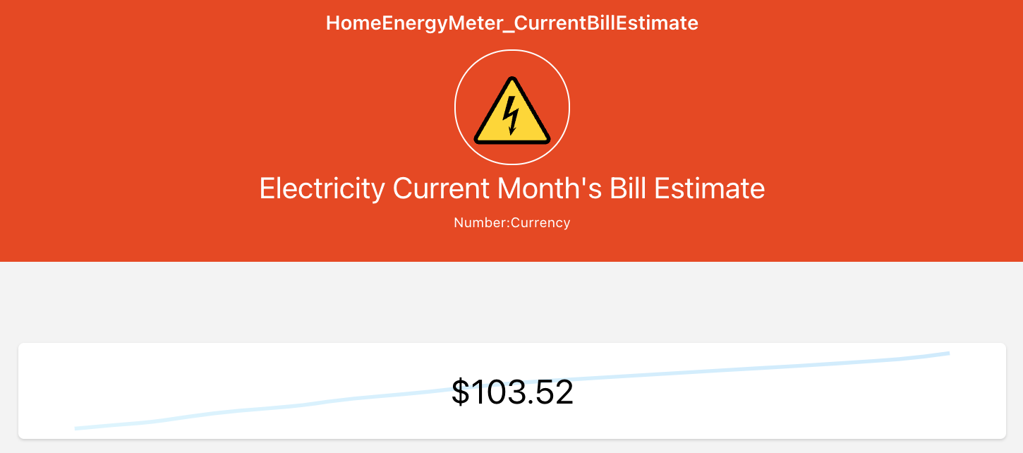

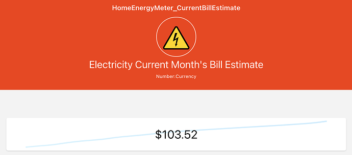

Trigger the rule when any of the Items the calculation depends on changes. First get the three values for the calculation as Quantity types (i.e. don’t throw away the units).
Multiply the current kWh reading by the energy price rate. The kWh units cancel out resulting in just a monetary value. Then add the line access fee to get the total power bill for the month thus far.

It does. The problem is unlike all other UoM, the unit for money goes before the number, not after. The UoM subsystem doesn’t understand this (yet?). If you just use %unit% what will be displayed will be 123.4667899 € instead of the expected €123.47.
As in all cases for all units and any other Item types, the state description is used to control how it appears. This is no different.
