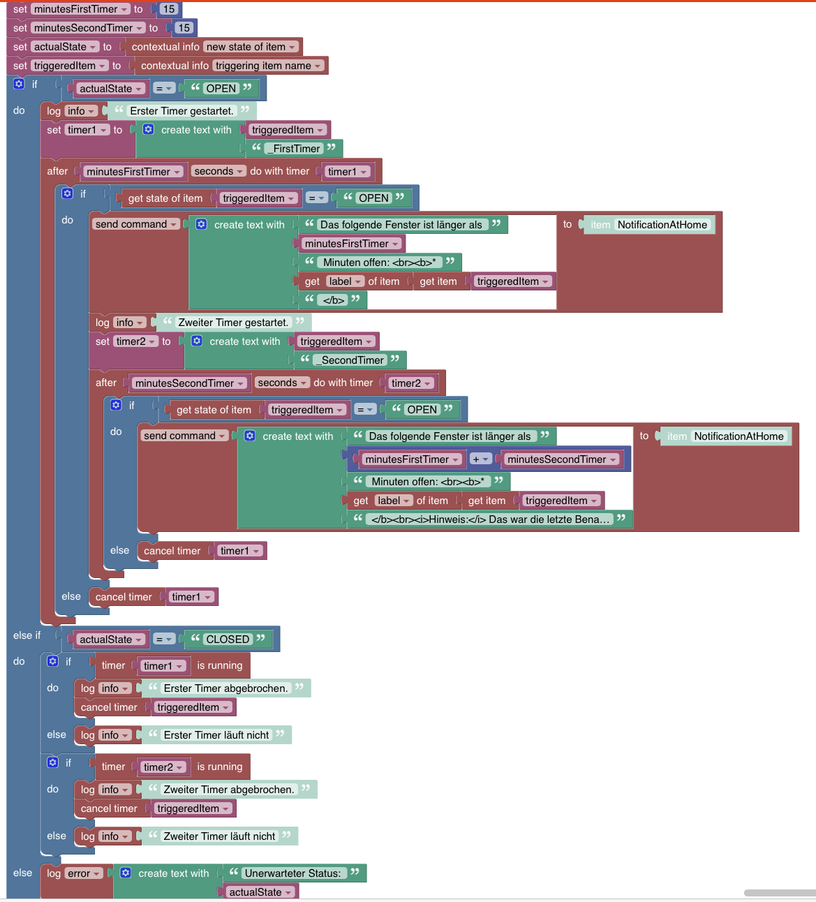

after some problems with my old openHAB installation, I installed openHAB 3.2 and set it up from scratch.
I also tried to use the new rule engine with blockly - but I have a problem with a timer. The rule ist triggered if a member of my window group changed to any status. I want to receive a notification if a window is open more than x minutes (second timer with additional x minutes). Because of debugging the rule I set it up to 15 seconds :wink:
If I open any window in this group, the timer starts and I receive both notifications. But if I close the window before the first or second timer is over, I see that the timer is not running (log info in the else-condition).
This is my blockly rule:
And the result in javascript:
var minutesFirstTimer, minutesSecondTimer, actualState, triggeredItem, timer1, timer2;
var scriptExecution = Java.type('org.openhab.core.model.script.actions.ScriptExecution');
var zdt = Java.type('java.time.ZonedDateTime');
if (typeof this.timers === 'undefined') {
  this.timers = [];
minutesFirstTimer = 15;
minutesSecondTimer = 15;
actualState = event.itemState;
triggeredItem = event.itemName;
if (actualState == 'OPEN') {
  logger.info('Erster Timer gestartet.');
  timer1 = String(triggeredItem) + '_FirstTimer';
  if (typeof this.timers[timer1] === 'undefined' || this.timers[timer1].hasTerminated()) {
    this.timers[timer1] = scriptExecution.createTimer(zdt.now().plusSeconds(minutesFirstTimer), function () {
      if (itemRegistry.getItem(triggeredItem).getState() == 'OPEN') {
        events.sendCommand('NotificationAtHome', (['Das folgende Fenster ist lÀnger als ',minutesFirstTimer,' Minuten offen: <br><b>* ',itemRegistry.getItem(triggeredItem).getLabel(),' </b>'].join('')));
        logger.info('Zweiter Timer gestartet.');
        timer2 = String(triggeredItem) + '_SecondTimer';
        if (typeof this.timers[timer2] === 'undefined' || this.timers[timer2].hasTerminated()) {
          this.timers[timer2] = scriptExecution.createTimer(zdt.now().plusSeconds(minutesSecondTimer), function () {
              events.sendCommand('NotificationAtHome', (['Das folgende Fenster ist lÀnger als ',minutesFirstTimer + minutesSecondTimer,' Minuten offen: <br><b>* ',itemRegistry.getItem(triggeredItem).getLabel(),' </b><br><i>Hinweis:</i> Das war die letzte Benachrichtigung!'].join('')));
            } else {
              if (typeof this.timers[timer1] !== 'undefined') {
                this.timers[timer1].cancel();
                this.timers[timer1] = undefined;
      } else {
} else if (actualState == 'CLOSED') {
  if (typeof this.timers[timer1] !== 'undefined' && this.timers[timer1].isRunning()) {
    logger.info('Erster Timer abgebrochen.');
    if (typeof this.timers[triggeredItem] !== 'undefined') {
      this.timers[triggeredItem].cancel();
      this.timers[triggeredItem] = undefined;
  } else {
    logger.info('Erster Timer lÀuft nicht');
  if (typeof this.timers[timer2] !== 'undefined' && this.timers[timer2].isRunning()) {
    logger.info('Zweiter Timer abgebrochen.');
  } else {
    logger.info('Zweiter Timer lÀuft nicht');
} else {
  logger.error(('Unerwarteter Status: ' + String(actualState)));
I’m a little bit confused :confused:

I expected, that the timer was running (and canceled), when the rule was triggered after I close the window.
A timer running means it is currently executing the code inside its timer block. This event will usually only last a few milliseconds, and you’d be (un)lucky to catch it when your rule retriggers.
A timer active means that the timer is currently counting down.
You may want to check whether your timer is active, rather than running.
Check the draft reference here.
