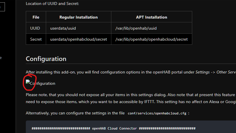

It would be great if they would update the openHAB Cloud Connector documentation with the correct file locations of the UUID and Secret documents for Windows users. I had no trouble finding them but it’s annoying that so many sections of the documentation are incorrect or omit information when it comes to those installing openHAB on a Windows machine:

Your screenshot points to userdat/uuid for the UUID file, so it shall be found in
C:\openHAB\userdata\UUID
Where is the issue ???
My apologies - you are correct. I somehow didn’t see/completely ignored the first column for “Regular installation” and only saw the second column, with the “var/lib/openhab…” file location. Obviously a Windows installation cannot be an APT/repository installation and thus falls under the Regular installation category, and the file locations currently provided there in the table are indeed correct. Sorry about that.
There does seem to be a graphic or screenshot of some sort missing however from the beginning of the next section:
This is the URL for the missing graphic, which points to a 404:
https://www.openhab.org/addons/integrations/openhabcloud/contrib/doc/cfg.png

content on github https://github.com/openhab/openhab-addons/blob/main/bundles/org.openhab.io.openhabcloud/README.md contains a picture/screenshot instead of the alternate text “Configuration”
Ok, I see. Don‘t know ehy this differs from the docs page..
@Confectrician ??
The github file uses a relative url to show the image.
This url is not available on the homepage, even if the picture gets transferred correctly.
We would have to change the readme file, which breaks the view on github, but will then work on the homepage.
Unfortunately, we can’t have both working parallel. :man_shrugging:
