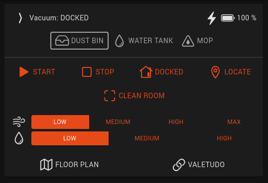

Valetudo vacuum robot control widget
This widget allows controlling and showing the status for Valetudo vacuum robots configured via MQTT.
You should configure your Valetudo thing/items as documented here: openHAB | Valetudo
In particular and most importantly the item names should not be changed from the automatic default names, otherwise the automatic detection of vacuum functionality will not work.
Screenshots
Resources

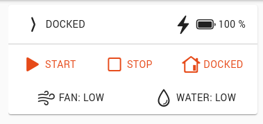

    - description: If enabled, fan speed and water grade selection will be available in a menu. If not enabled, buttons will be shown in the widget.
      label: Compact fan speed / water grade
      required: true
      type: BOOLEAN
      groupName: display
