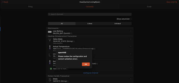

since several days I have a issue with openHAB and the Homematic Binding. I reinstalled openHAB in order to fix the issue, but it still appears…
I have configured multiple heating control groups in Homematic and added (actually) one of them as things in openHAB via auto-discovery. Whenever I configure the “SET_POINT_TEMPERATURE” to increase the delay timer I get the error message “Please review the configuration and correct validation errors” after a few seconds. There are no ERROR-Messages in the log.
Detailed steps:
- Added HeatingController via auto-discovery from homematic-bridge
- “Configure Channel” on “SET_POINT_TEMPERATURE”
- Setting “Delay” and “Receive Delay” to 5 seconds
- After clicking on “Done” the error occures and the “Save”-Button cannot be clicked
I think this error occures since I updated my old openHAB version. I completly reinstalled openHAB because I tought I miss configured something, but this error still occures on a clean install/setup. Maybe there are some similarities with this issue?
