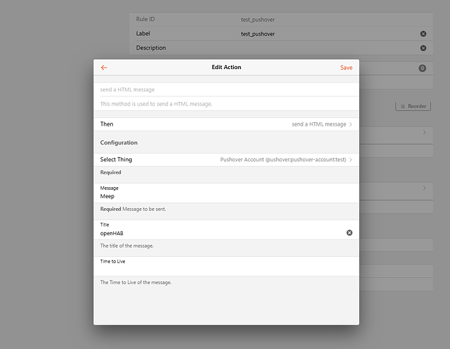

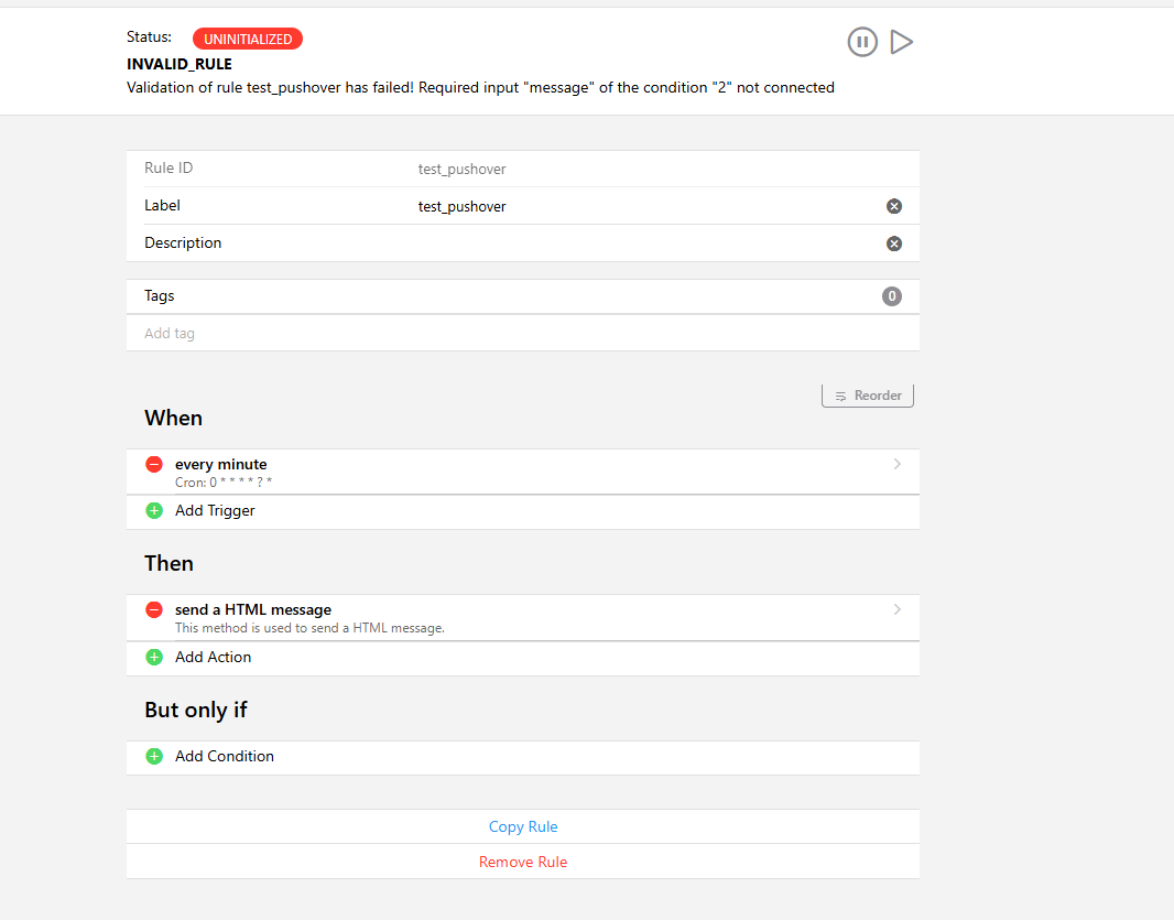

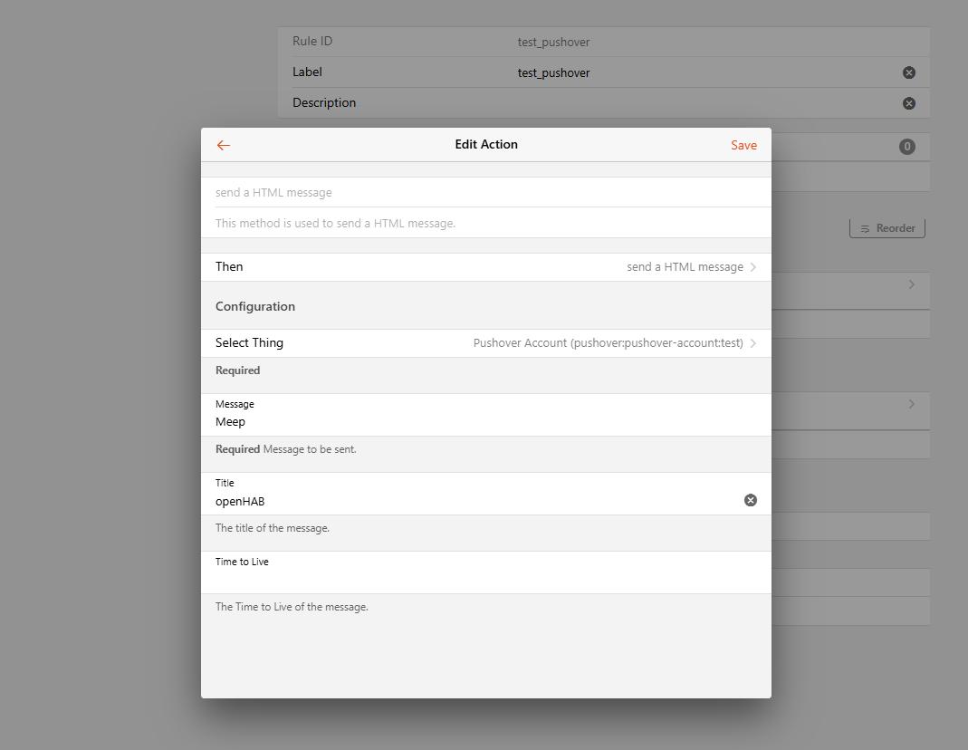

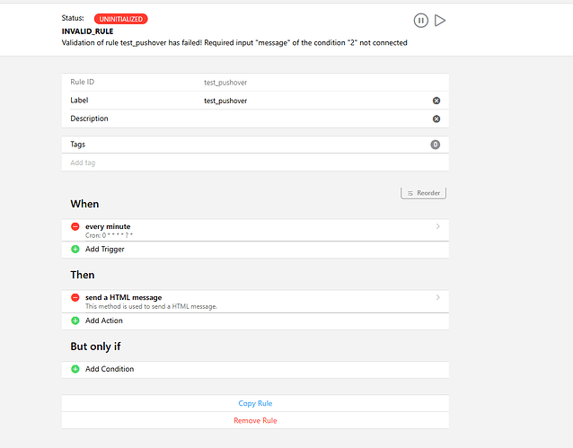

I am unable to send messages through any pushover item when I create a rule in the GUI. I’ve been using pushover for years with rules and items defined in files and just recently tried to do it through the graphical interface. The error is this:
Validation of rule test_pushover has failed! Required input "message" of the condition "2" not connected
But I have a message:
Any suggestions? There’s nothing in openhab.log.

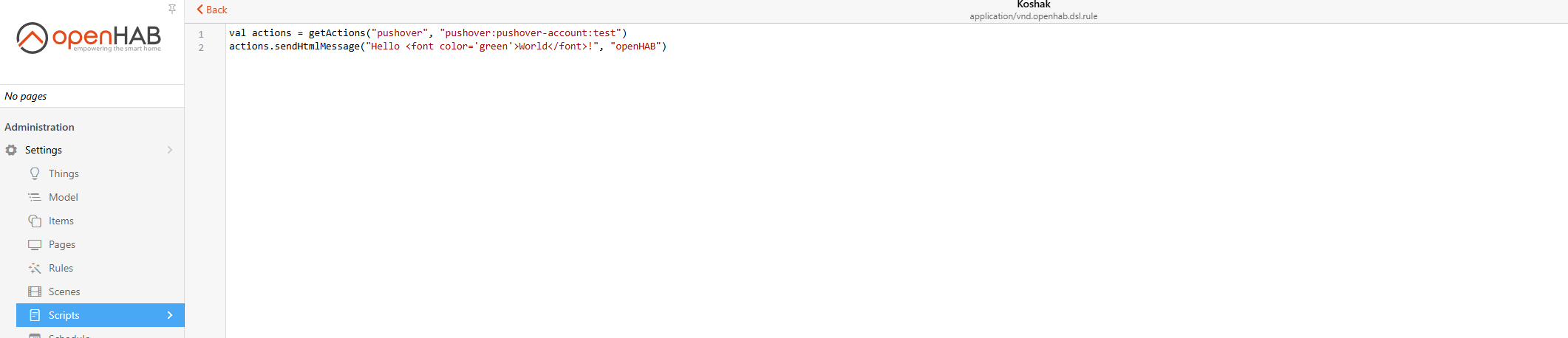

Are you able to call this Thing Action from an Inline Script?

I am not sure exactly what is it I should do, I haven’t used inline scripts before nor called Thing Actions. Do you have a template perhaps?
I can do this, which works
Mvh.

And there is nothing in the log files, the error message is only showing in the GUI.

OK, that shows the problem is with the UI or core or possibly with the add-on.
I think it’s with the UI so file an issue on the openhab-webui repo.
In the mean time, you’ll have to use an inline script for your rule action to send messages to Pushover.
You can use Blockly if you install the Pushover Block Library first. You can find it under Add-on Store → Automation → Block Libraries. Then in the Blockly editor you’ll find it under Libraries.

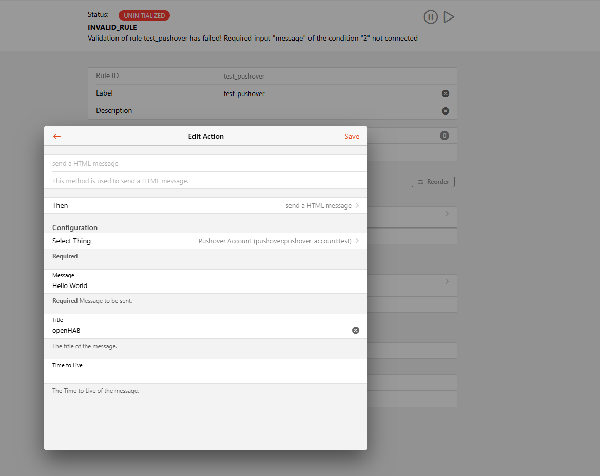

opened 05:49PM - 24 Feb 25 UTC
bug
Redirected here from the [forum](https://community.openhab.org/t/validation-of-r… ule-test-pushover-has-failed-required-input-message-of-the-condition-2-not-connected)
Trying to create a rule that will send a message with pushover but unable to save it due to:
The generated code looks fine to me:
```yaml
configuration: {}
triggers:
- id: "1"
configuration:
cronExpression: 0 * * * * ? *
conditions: []
actions:
- inputs: {}
configuration:
message: Meep
title: openHAB
config: pushover:pushover-account:test
type: pushover.sendHtmlMessage#9e8ead2776057c93222de16046c654cf
## Expected behavior
Rule works
## Steps to reproduce
Create a rule and try to use any pushover action with a message.
## Your environment
Podman running openhab:latest

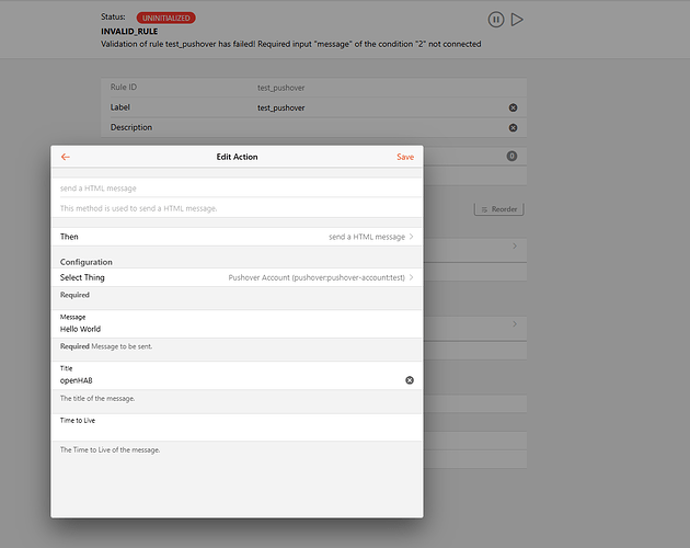

## Browser console
Nothing in the logs, error only showing in the UI.
Some screenshots:
This scripts works fine:
Thanks, I’ve created a ticket and I’ll try Blockly.
