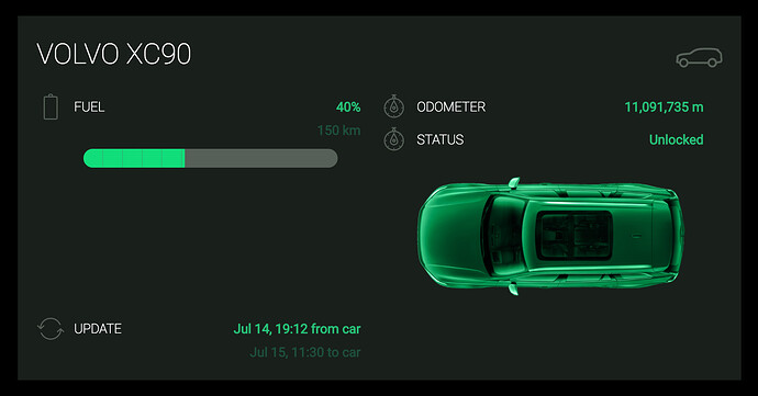

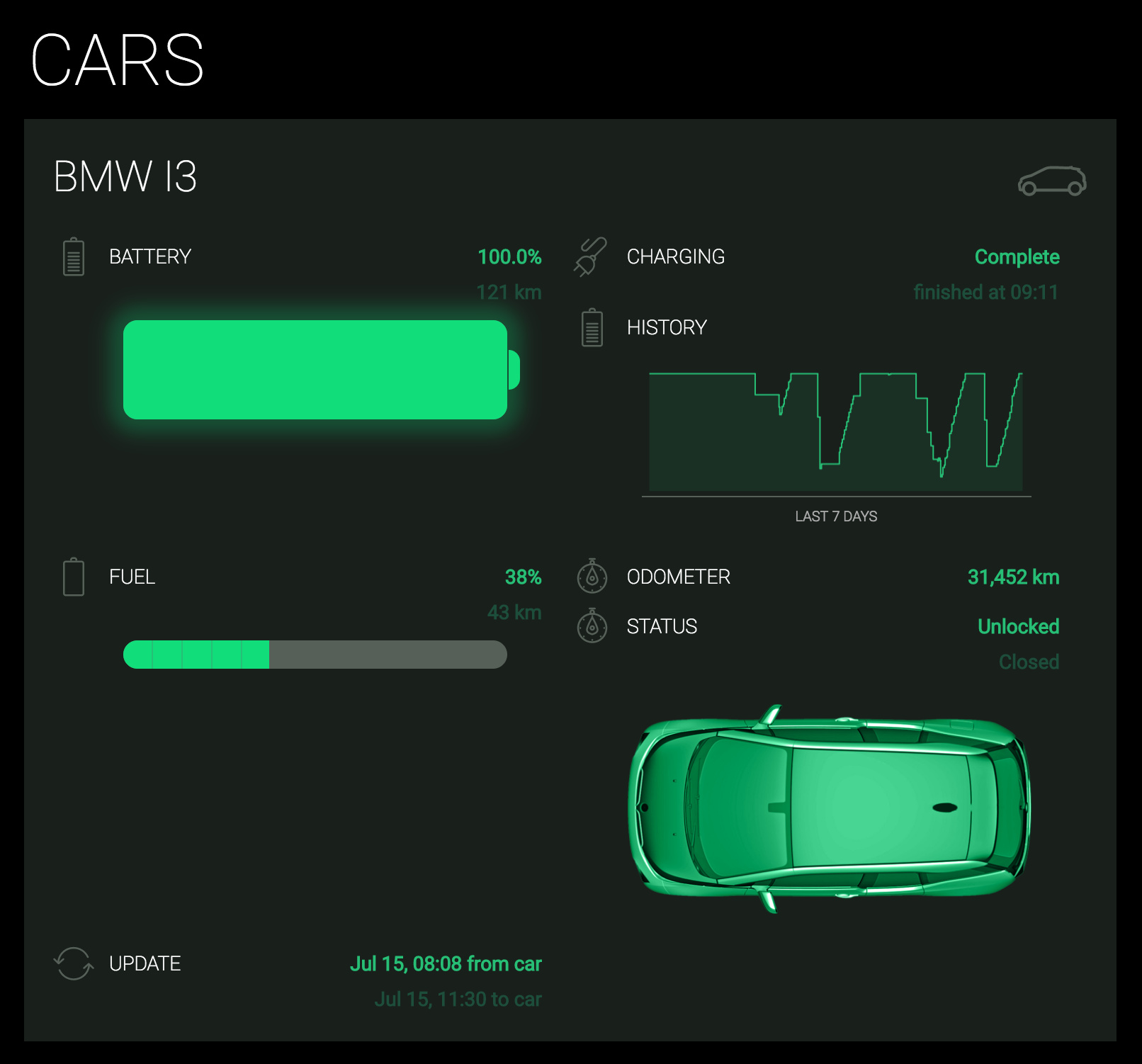

I have a python script that integrates into BMW Connected Drive and Volvo VOC API. Both work great. I’m cleaning it up and will post to GitHub when ready.
Works on all models that can connect to ConnectedDrive and VOC.
My HabPanel looks like this:

Can you share you script? I have a 2017 XC90 and is looking for a way to do this with HomeSeer.
@pmpkk I’m also interested in your piece of code, thank you!
Looks great.
Are your vehicle icons svg format?
Would you mind sharing your xc90 icon?
Hey… I’m using the Volvo On Call binding to get get data from VOC and that works great. I’ve taken the HABPanel widget from your github and imported it but I can’t get the fuel gauge to work… I can’t work out what the equivilent channel within the binding would be for the item you’ve called “volvo_fuelAmountLevelName”. any clues??
