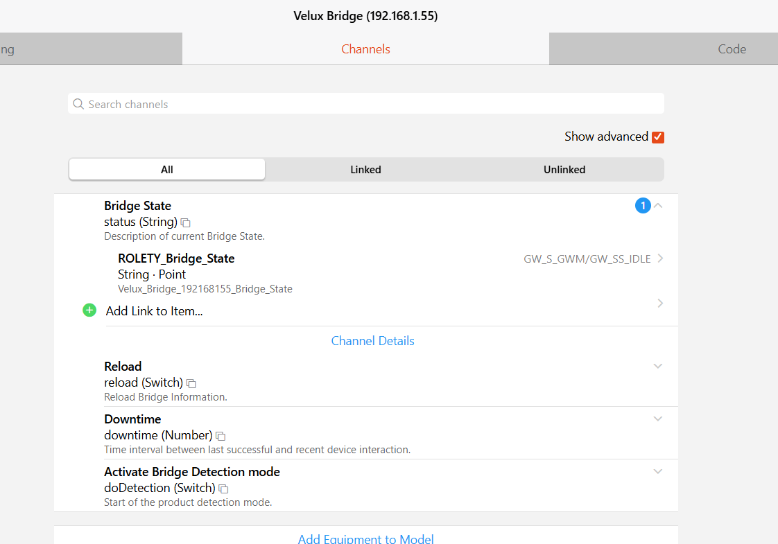

I have rollershutter and window actuator connected to KLF200

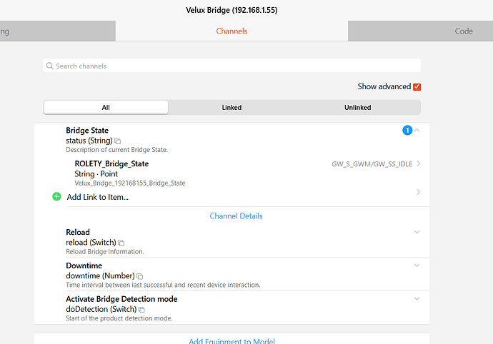

Question is, where I can see that window is moving ?
In the bridge status I can see all the time : GW_S_GWM/GW_SS_IDLE
Status is changing only when rollershutter is moving.
Thank you
Alex

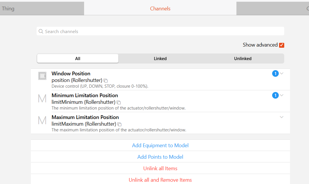

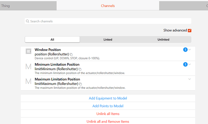

When I will look into thing:
there isn´t any status, only position item. This I´m using to start movement. I will send a value to this item.
But when movement start, bridge state will change :
but only for rollershutter, not for window.
So question is, is there any way to know, that window started/finished movement ?
Alex
edit:
when rollershuter start movement, bridge status will change to :
and when movement is finished, status will change to :
but for window movement it doesn’t work, there is bridge status still :

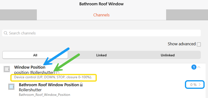

Ah. Not to be impolite, I think it is a case for “RTFM” =>
Rollershutter is an OH Item type that is used for controlling Thing Channels with UP/DOWN/STOP commands or Percentage Position commands. (It says exactly that on your screen shot).
In your screen shot for the “Window Position” channel if you press the blue down arrow button you will see such a Rollershutter Item linked to that channel. And its display will indicate the respective window percentage position. See example below..

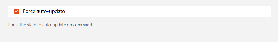

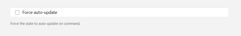

The default behaviour of OH is that when you send a command to an Item, its state is immediately “auto-updated” to the new commanded value (even though the device has not yet reached that value); and when on the next polling cycle (maybe 10 seconds later) the actual position is fetched from the device the Item will be updated with that value.

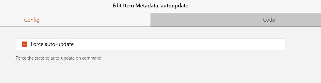

EDIT: you can override the “autoupdate” of the Item by setting its respective parameter..
so If I good understand, I can somehow set, that I will send to the item a value (for example 50), but item value will remain with default (start) value till new position is reached ?
How can I do it ? Is it possible from the UI ?
Main UI | Settings | Items | your item | Add Meta-Data | Auto-Update
thank you
what is : - ?
there is also possible set
and
The last one..
thank you

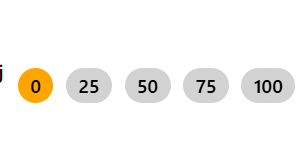

Till now when I clicked on the value, action was send this value directly to the item.
But maybe now I must change somehow, because I must set my personal item (maybe string) to value “movement” and also send a value to the item.
And when item value will change (window reached position) - I must set my personal item to “movement done”
I!m not sure if I can do two action directly from the widget
 - component: oh-button
                          action: command
                          actionCommand: "100"
                          actionItem: =props.groupItem1

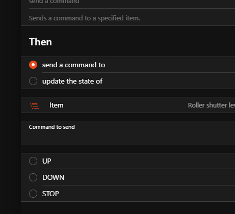

Is it possible send a value from other item directly to the rollershutter item, or I must create a DSL script ?
edit:
I did it via DSL script :
Roller_shutter_left_Position.sendCommand(RS_left_task.state.toString)
