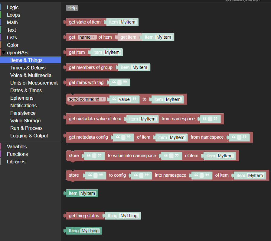

I’m not so familiar with Blockly, but I will check
edit:
can’t find this

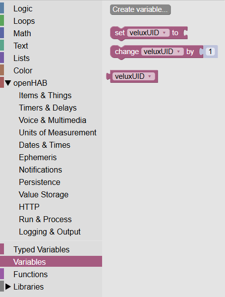

Create a variable and name it veluxUID
thanks, I’m lost with blockly
also can’t find next instructions :
I see this:
Ok, my mistake. The additional thing blocks have been added recently, so are not available in your version.
Sorry …
