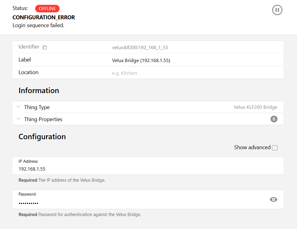

I’m using KLF 200 and Velux binding
Problem is, that this binding stop working and I don’t know why.

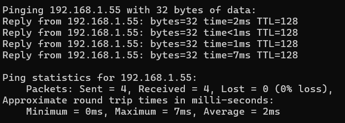

KLF 200 I can see on the network :
also I can ping a device:
also I can connect via wifi directly to web page of the device
but under openhab I have a error :
configuration is the same how it was working before
Please how to trace a root cause of the problem ?
Thank you
Did you set the correct password? It is not the default password „velux123“ according to the binding‘s documentation.
If I remeber correctly it is the web user‘s password.
yes, it’s password from the back side of the unit

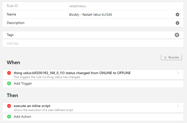

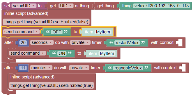

The KLF200 has the annoying habit of going zombie every now and then for quite a lot of us. Try disabling the bridge thing, unplugging the KLF200, wait some time (10 seconds, or a bit more) before plugging in the KLF200 again. Wait a little more (solid green light on the KLF200) and enable the bridge thing again.
I now have a rule thet does this automatically with the help of a smart plug.
ok, I will try restart. Please can you share your automatic restart solution ?
See this topic

It can also be done in blockly
Just change the name of the bridge thing and add the name of your switch item…
AFAIK, the WiFi connection of the KLF200 closes after 10 minutes, therefore I set the second timer to 11 minutes.

Why not going the Blockly way and avoid old DSL rule ???
