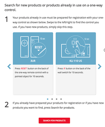

Did you already paired a remote control, (e.g. Telis, Situo, etc.) to your rollershutters?
If yes, then:
Press on the “PROG” button of one already programmed situo transmitter, until the roller shutter completes the process a short up and down movement approved. (approx. 2 sec.).
Then go into your KLF200 and click on “Search for Products”.
