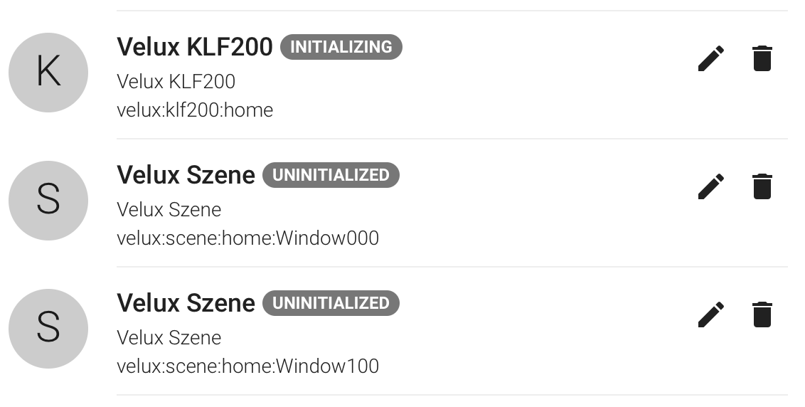

Afterwards i can search for things → choose Velux binding → nothing happens.
So i manually add and get a thing. But the status don´t go to online. It shows initializing.
As LOG Fioles shows some timing issues i increased timeout to 10000 but no sucess.

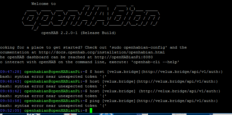

Dear Guenther
Thanks for your quick response.
Connected via Putty to my Raspi but …
could not manage to get commands running ??
As i´m relativ new on Linux ii sent you the screenshoot
KArl
If i ping the IP direct i get response
If i try : ping [velux.bridge]
i get the following: ping: [velux.bridge]: Name or service not known
If i try host with the command : host [velux.bridge]
i get : Host[velux.bridge] not found: 3(NXDOMAIN)
Hope this helps

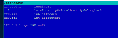

This is my hosts file.
Additionally i figured out that i can not remove the thing in the paper UI. Get always : Error: 409-conflict
Only if i remove or rename the textual configured thing file the thing disappears.

I have in the textual thing configuration the IP Adress in.
But in the thing which i can open with paper UI there is
http://velux.bridge:80 writte in which i can´t overwrite.
Same error as i try to delete thing in Paper UI.
Error: 409 - conflict
Got working it thing is now online:
remove the textual thing file
Add manually via Paper UI a velux thing
Got thing ID and change URL to the static IP adress i have with port 80.
Now thing is online. Try now to get my predefindet scenes from the KLF200 up and running.

2018-05-30 22:38:36.884 [.ItemChannelLinkAddedEvent] - Link 'VeluxKLF200_IPAdresse-velux:klf200:d63e074a:ipAddress' has been added.
2018-05-30 22:38:38.626 [hingStatusInfoChangedEvent] - 'velux:klf200:home' changed from UNINITIALIZED to INITIALIZING
2018-05-30 22:38:43.635 [hingStatusInfoChangedEvent] - 'velux:scene:home:Window000' changed from UNINITIALIZED to UNINITIALIZED (BRIDGE_UNINITIALIZED)
2018-05-30 22:38:43.636 [hingStatusInfoChangedEvent] - 'velux:scene:home:Window100' changed from UNINITIALIZED to UNINITIALIZED (BRIDGE_UNINITIALIZED)
Why seems the velux binding to be registered, if Bundle:list only shows one binding (240) as registered?
In Paper-UI Brigde and Szene stay uninitialized.
What can I do to get your binding running?
Bert
