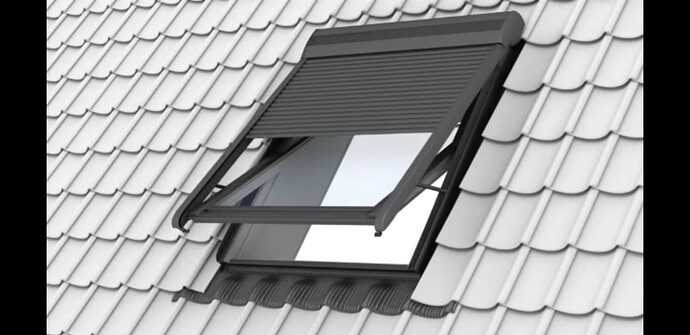

the make is Velux and they do not move with the window frame, their rails are still on the roof. It’s standard Velux rollershutter for the model I have, which is Velux Integra.
I would have expected this clashing conflict be managed at firmware, within the IO home controller, but it’s not the case.
What I’m hoping is to be able to introduce some safeties using openHAB rules and your binding, but I’d need an “abort” command or something like that.
any ideas?
Hmm. That is odd. Mine look like this..
See also the installation video below (from time mark ca. 2:30 onwards..)
But obviously notwithstanding the above, you could indeed write two rules in OH..
  • if window position commanded to > 7% (vent) then shutter position => 0%
  • if shutter position commanded to > 0% then window position => 0%
