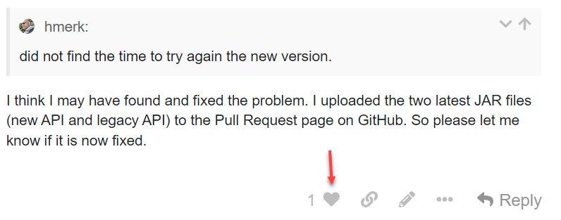

@hmerk I saw that you “liked” my post, but for the avoidance of doubt, can you please confirm that “liked” == “tested” == “working ok” for you? :slight_smile:
Sorry @AndrewFG, it was just a „like the progress you are making“
