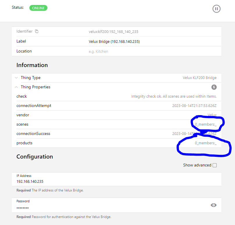

i have a klf200 with 6 roof windows connected to it
i can see the products in web page and controll them via scenes
but in openhab 4.0.1 it can not see the windows or scenes even after a scan
if anybody fixed please help

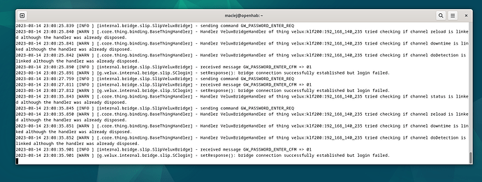

update
checked the logs, maybe somebody can shed some light
it said the password is wrong but shows as connected and online
i do not get it please check below the screenshot
UPDATE!!! SOLUTION!!!
Use the Wifi password from the web interface as a password in bridge Thing!
not velux123 default password
it worked for me
That’s what is also written in the documentation:
(**) Note: This password is the API password that is printed on the back of the unit. Normally it differs from the password of the web frontend.
