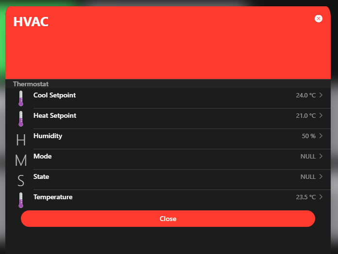

I bought and installed a Venstar ColorTouch thermostat. The temperature ad set points and humidity are displaying but the mode and state are not showing. I also cannot change the setpoint or mode.
Any help appreciated.

I did get the mode and state display working. The examples in the documentation are incorrect. I needed to set the type to string or use the raw values.
However, I still cannot change the mode or set points from OpenHAB.
