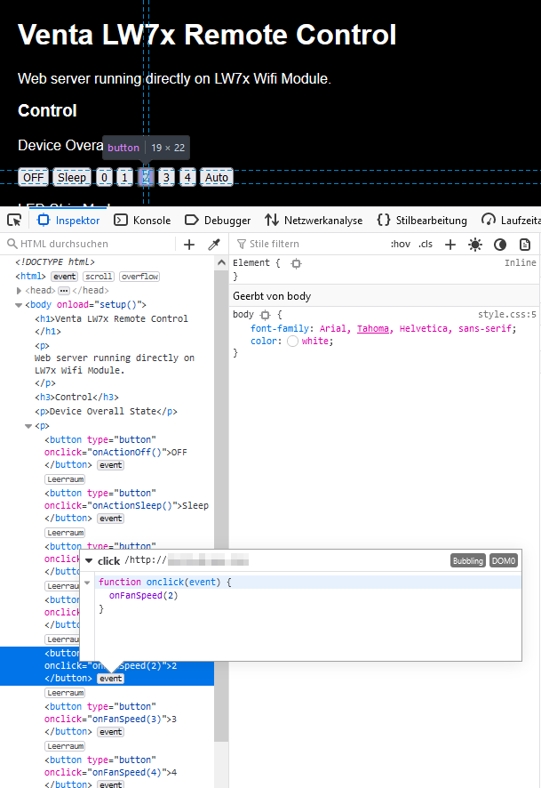

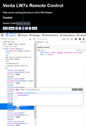

When I was sniffering the network I found out, that the Venta App (not the Venta Home App!) isn’t using UDP port 48000. Instead of this, TCP port 80 (http) is used for reading/setting parameter.

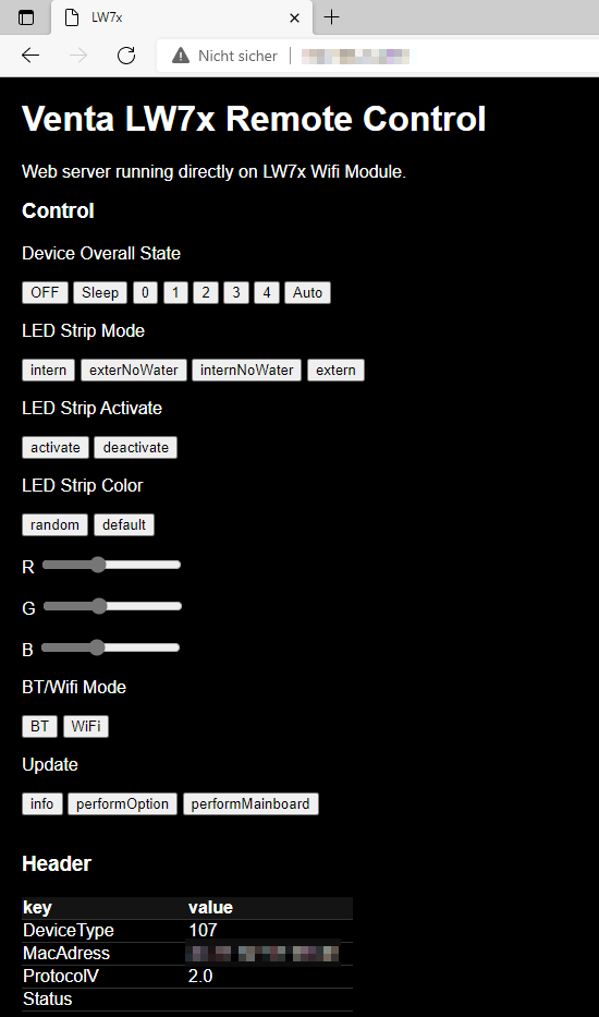

I also found out, that the Venta Aerostyle LW74 has a webserver. This interface is fully open, a password is not needed. The user has direct access to values and can fully control the device.
