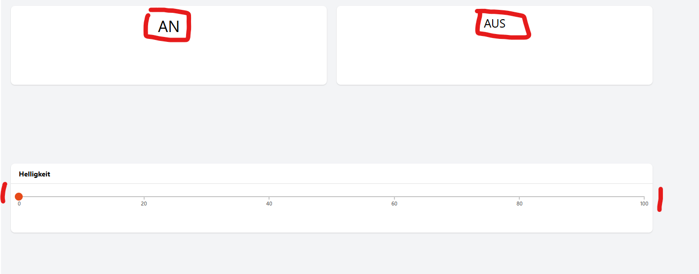

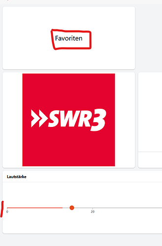

I’m creating a dashboard with fixed canvas layout with some standard library widgets like “oh-label-card” or “oh-slider-card”. I noticed that the vertical alignment of the content of these cards is different than wehn using these widgets in a fixed grid layout or layout page. “preserve classic style” is set to true. Is this intended behavior? If yes, how can the content be vertically centered?
Example of a grid layout (all contents are vertically centered within the cards):
Example of a fixed canvas layout (contets are not vertically centered):
