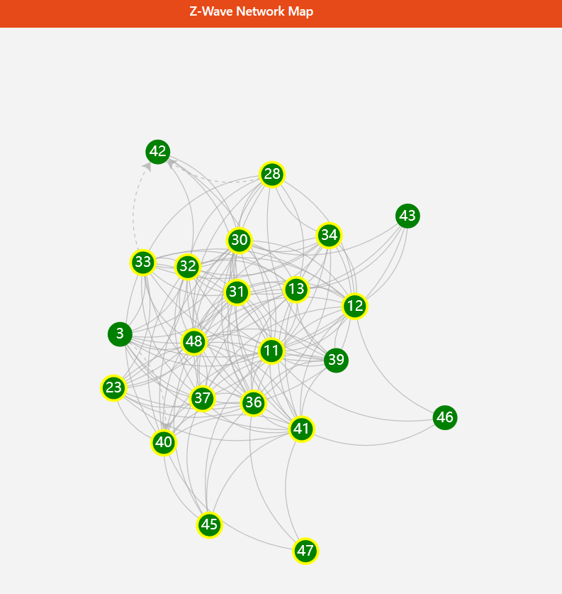

BTW in OH3, trying to view the ZWave network gives a blank page.

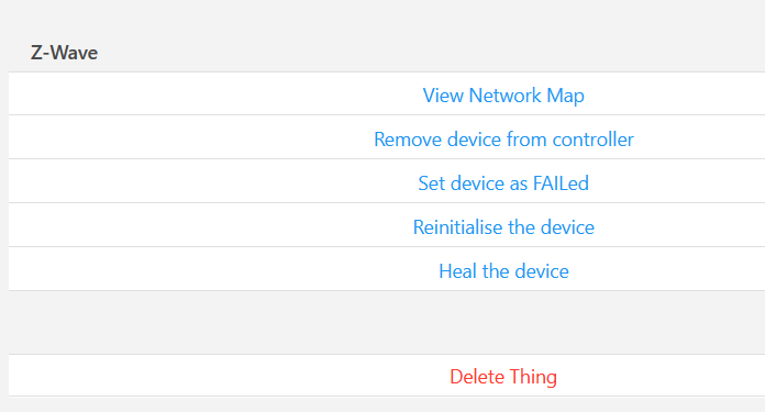

On your device Thing, go all the way down to the bottom:
You should see your network again after the nightly heal:

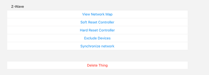

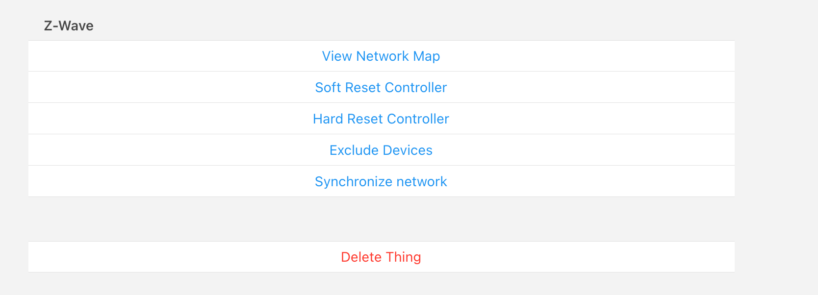

Unfortunately, I am not getting the same thing as you:
There’s no Heal option in the stick page.
PS: The heal option appears on other devices, not on the stick’s page. Does it do the same thing as a heal of the whole network? Clicking on one device’s heal option does not seem to help anything.
PPS: Trying heal on the closest node to the NUC/ZWave stick seems to have awoken a bunch of actions on the stick and it seems to be flashing as expect during normal operations. Seeing some of the debug messages, I ended up unplugging a smart strip (node 55 in the logs) and so far the network is back to normal. Will post further updates.
