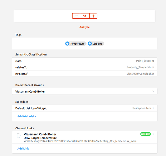

I am currently trying to set the hot water temperature. The idea is to only heat it to 60°C for an hour every other day to avoid legionella, otherwise a lower temperature is enough for me.
Unfortunately, the value I set in OpenHab (heating_dhw_temperature_main) is not accepted and is overwritten with the configured value in the Viessmann time program, even if the time program is inactive or the corresponding day has even been deleted.
I use Openhab 3.4.2 and the binding version 3.4.
Am I doing something wrong by simply setting the value of the item?

Unfortunately, success has not yet come. Here is my item definition:
Number:Temperature Viessmann_DHW_Target “DHW target temperature new” (gEveryMinute) {channel=“vicare:heating:23be91b3d7:163f539d-dd98-3493-9522-26a506a61922:heating_dhw_temperature_main”}
And here is the corresponding event log:
2023-03-26 10:55:10.142 [INFO ] [openhab.event.ItemCommandEvent ] - Item ‘Viessmann_DHW_Target’ received command 50 °C
2023-03-26 10:55:10.147 [INFO ] [penhab.event.ItemStatePredictedEvent] - Item ‘Viessmann_DHW_Target’ predicted to become 50 °C
2023-03-26 10:55:11.326 [INFO ] [openhab.event.ItemCommandEvent ] - Item ‘Viessmann_DHW_Target’ received command 45 °C
2023-03-26 10:55:11.330 [INFO ] [penhab.event.ItemStatePredictedEvent] - Item ‘Viessmann_DHW_Target’ predicted to become 45 °C
2023-03-26 10:55:11.346 [INFO ] [openhab.event.ItemStateChangedEvent ] - Item ‘Viessmann_DHW_Target’ changed from 50 °C to 45 °C
And then comes the unexpected:
2023-03-26 10:55:21.354 [INFO ] [openhab.event.ItemStateChangedEvent ] - Item ‘Viessmann_DHW_Target’ changed from 45 °C to 55 °C
The value will be written back from somewhere a little later. Unfortunately, the set value is never displayed in the Vicare either, only the value set in the time program is displayed.
Do you have to switch off the time program or will it be overwritten?

How exactly to you set the DHW target temperature? A slider on HABpanel or sitemap or through a rule or…?
It’s the same situation, dhwAndHeating and also a running DHW Programm.
All things are permanently online.
Originally the temperature values were set from the UI:
Setpoint item=Viessmann_DHW_Target minValue=8 maxValue=60 step=5
Currently I have written a small program that is called every 5 seconds:
if (itemRegistry.getItem(‘Viessmann_DHW_Target’).getState() != 50){
events.sendCommand(‘Viessmann_DHW_Target’, 50);
log.info(‘Viessmann_DHW_Target was reset.’)
It is noticeable that there are regular “updates” from Viessmann and then the value is reset by the program. Here’s an example:

Hi, looking at the log, I suspect one of two things:
  • the value is being sent to the API as otherwise I would expect a WARN level error message that you should see, assuming that your log4j2.xml is configured to show it. Then something is countermanding it (either from OpenHAB or somewhere else)
  • the value is dropped by the binding because the control that sends it maybe is sending an unrecognised value type. I suspect it may be this.
Increase the log level to TRACE by inserting the following into log4j2.xml
            <Logger level="TRACE" name="com.qubular"/>
Hopefully that will show some more detailed output. Unfortunately OpenHAB doesn’t really provide bindings any great way of reporting transient errors due to failure to execute commands for some errors there may be a status change on the binding or the item, but it’s likely to only be momentary.
For reference, it works on my install and my Item configuration is as follows:
