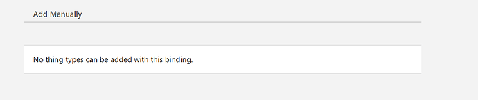

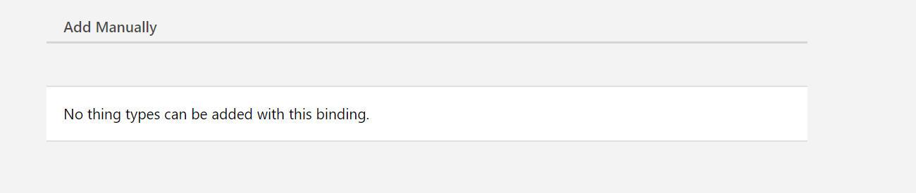

Hi Team,
what is required to update that binding to 4.x.x?
Anything we can do to workaroud the current incompatibility meanwhile?
[Edit] The following answer apolies only to the Smarthome/J Viessmann Binding.
I had the same issue! A simple Remove and (Re-)Install of the binding did solve that one!
