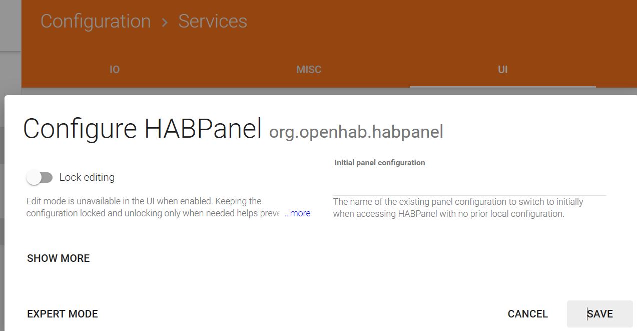

thank you. this is a first step. but only a … very simple step i thought about editing the source code of the html file(s) of the habPanel but i cant find the source on my server (raspberry) does anyone knows the location of the html file(s) ?
