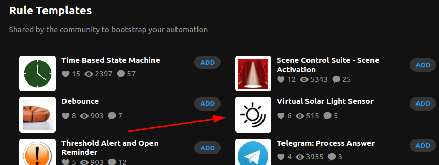

This is totally weird but I’m not seeing this in my list of rule templates to install, even when I toggle “show unpublished” for the community marketplace. Your version string looks fine and I see no other reason why it wouldn’t be listed.
I’m on a 4.1 snapshot from a week or so ago (upgrade to the latest is in process). Can someone confirm whether it’s just me or if this is a wider problem?
I am on a milestone and I can see it, but I already had it installed, so may not be the same situation.
That’s definitely part of it. I just removed my Presence Simulation rule template that uses the exact same versioning as above. I need to experiment to figure out if our version string is wrong or if there is a bug that needs to be filed. I’ll come back with my findings.
Thanks!
My dev instance was at 4.0.2 and now is at 4.0.3. In both versions it is listed.
I don’t think this is a problem with 4.0.x releases, only 4.1. Thanks for confirming.
I think the current snapshot is borked. Errors everywhere from Zigbee. I’m going to go back to 4.1 M1 and will report back when I see what’s going on there.
I figured it out.
The version numbers are not working because snapshots and milestones have third and fourth level version numbers. [4.0.0.0;4.1.0.0) is excluding the snapshots and milestones because I think it means 4.0.0.0 <= x < 4.1.0.0 and 4.1 M1 is greater than 4.1.0.0.
I’ve been able to make Presence Simulation show back up using [4.0.0.0;4.9.9.9]. I’m sure other ways that will work. That’s just the first one I happened upon. I’ll continue to experiment a bit but it looks like the fix is to change the version ranges in the titles.
