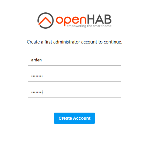

cmd line launches but web saying “No service was found”
picture attached
That’s some nice progress. :slight_smile:
Does it show any warnings/errors in the log files or when you enter the log:tail command in the Karaf Console?
