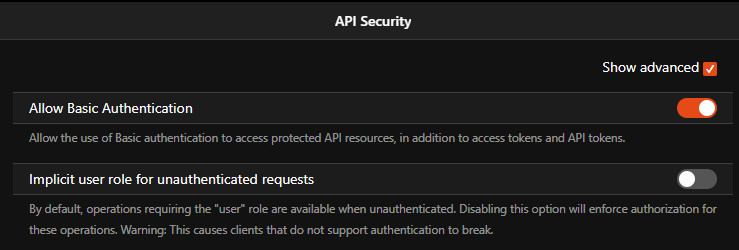

Hey there, i had the same Problem.
Please head to API Security, enable “show advanced” disable “Implicit…”, hit “save”, that worked for me

@Dynamyte
No difference for me (I had already tried that, but I gave it another go anyway)

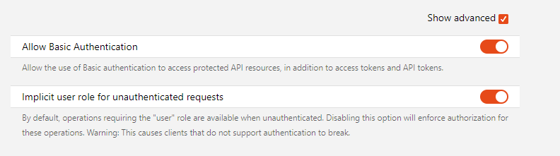

What I have discovered though that the API do not require authorization eg:
http://192.168.31.2:8080/rest/
shows all the APIs available

I have one last idea to get the problem sorted out a bit at least.
You could temporary disable the whole authentication for rest api via openHAB console.
When you are able to connect this way with the vscode extension (just host and port configured not user and passsword). We have to start looking at the authentication again.

So as I said earlier I realised that I did not need authorization to access the api, therefore I have deleted Username and Password in the VS Code settings and now I can connect (??)
I have Basic Authentication enabled
I am confused but can work for the moment
