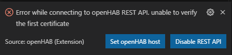

Did anyone handle the REST API connection between Visual Studio and Openhab with Nginx?
my jason file looks like:
    "http.proxyStrictSSL": false,
    "openhab.host": "https://openhab",
    "openhab.port": 443,
    "openhab.lspPort": 5007,
    "editor.renderWhitespace": "none",
    "editor.renderControlCharacters": false,
    "breadcrumbs.enabled": false,
    "workbench.activityBar.visible": true,
    "workbench.statusBar.visible": true,
    "window.menuBarVisibility": "default",
    "workbench.iconTheme": "openhab"
And I get following error:
Nginx working on 443 port and server name is “openhab”

It works like a charm in webbrowser but still not working in visual studio - maybe because i dont gave anything mentioned in Nginx conf file regardinf lsp port 5007?

Did anyone manage to use Visual Studio with Nginx? How to manage that?
I did combine intermediate certificate and still same error.
