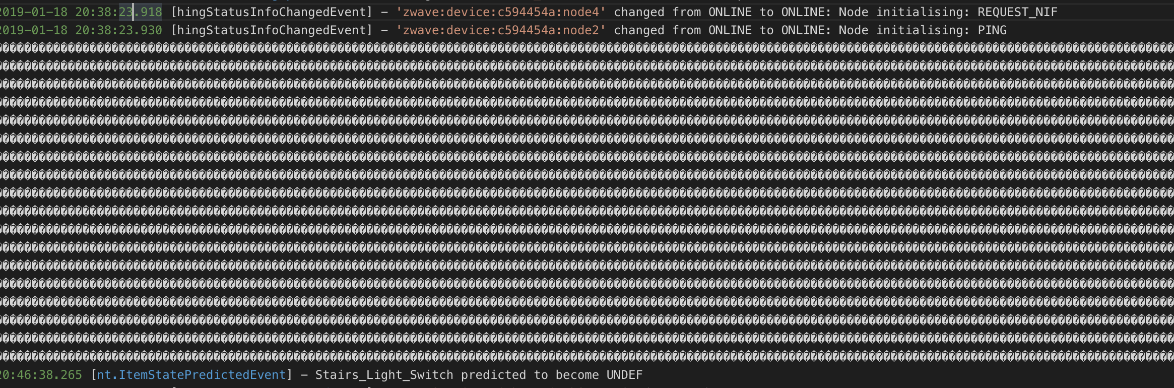

I started to use VS Code to tail log file and I noticed that sometimes instead of valid log it presents question marks. It looks like encoding issue. Does anyone have the same issue? Do I need to setup something? I am running it on MacBook Proand OH is running on RaspberryPie
I am having the same issue. Whenever I truncate the log file manually, the next time OpenHAB writes to it there will be corruption. VS Code will eventually get in sync and display the new log lines.
VS Code does not seem to offer a way to choose the encoding type when saving a file. Even if it did, I do not know what type the logger component is using. It is pretty messy unfortunately.
I would like to know what encoding is used, if I can change it and how.
Oh yes it does. Just have a look at the bottom part of your VSCode. There it somewhere (depending on what plugins you have installed) it should state the current encoding. When you click on it you get the options “Reopen with Encoding” and “Save with Encoding”. It’s also described here: June 2015 (0.3.0)
Indeed… I tried a lot of them, saving each time after making the choice. Still every time it was updated by OpenHAB it got messed up. I then tried a lot of them to read the messed up file to see if anything readable would emerge. It didn’t. VS always suggest UTF-8 (guessed from content) but it never recognizes the messed up parts.
I then looked at the binary data in the file. The question marks appeared to be all zeros (as in all bits are zero). No text logger should do this.
