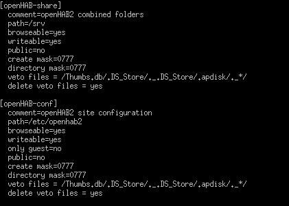

As per the installation docs, I have:
create mask=0777
directory mask=0777
In each of the shares
If you mean openhab in VS code then yes.
Can any of you guys share you samba settings?
Set your config to look like this, changing only the openhab-share and openhab-conf part, and give it a try.
