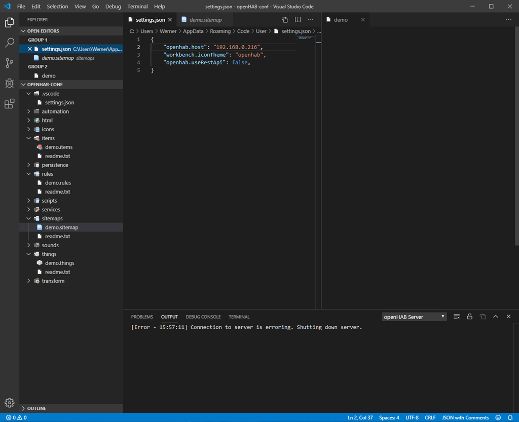

Hi , i’m strugling to get my visual studo code server to coorporate with my raspberry pi
I followed all instructions and can edit my files on the shared server , but when i try the Integrated Basic UI it gives the error as seen in the attachment, i’m at it the whole afternoon , but need some help please

The showed error message is a known und unresolved issue.
BUT it has nothing to do with the BasicUI.
This error is telling about an issue with the language “server” not the complete openHAB environment.
You want to show the basic ui of your demo sitemap in vscode?

After some testing i get a black screen (which seems your behavior from the screenshot) for my sitemap when the connection settings are not valid.
Are you sure about your IP and Port settings?
yes , triple checked;) tried with name, ipaddress , all the same , what did you mean with language settings ?

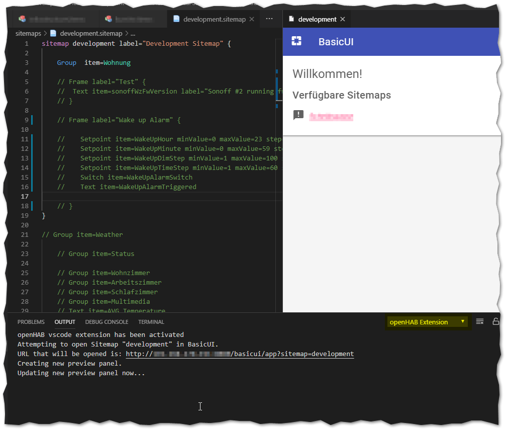

Hey @wen62,
Could you try this extension please?
https://github.com/openhab/openhab-vscode/files/3775027/openhab-0.5.1_outputChannel.zip
It contains a new output Channel which should provide logging information.
(I have added this now as a general method, so we can extend user logging in the future easily.)
Should look like this:
Please note that this is just an experimental extension for digging into this problem.
Since it is packaged on my current codebase it may contain some flaws,
so you should switch to the released version, when we have finished testing.

There is a yellow marked drop-down in my screenshot.
You can change the output Channel through this and there should be a Channel openHAB extension available.
Please check if it is as explained and if the extension channel produced some more logs.
