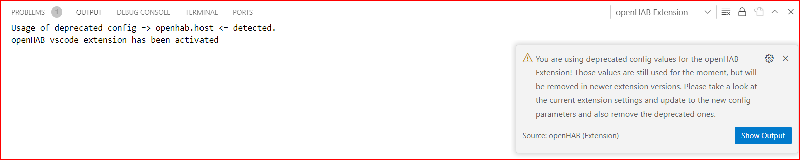

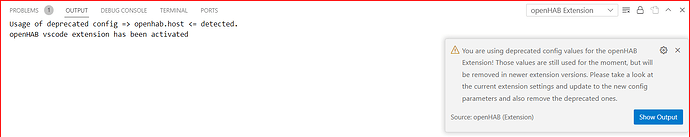

I searched package.json, found here (openhab-vscode/package.json at main · openhab/openhab-vscode · GitHub) for openhabianpi, and only found it under openhab.host So I tried adding it to settings.json:
    "openhab.connection.basicAuth.password": "myAPItoken, which I didn't include here",
    "openhab.connection.host": "192.168.1.9",
    "openhab.host": "192.168.1.9",
    "openhab.connection.port": 8080
But then Visual Studio compains about “deprecated config values”:

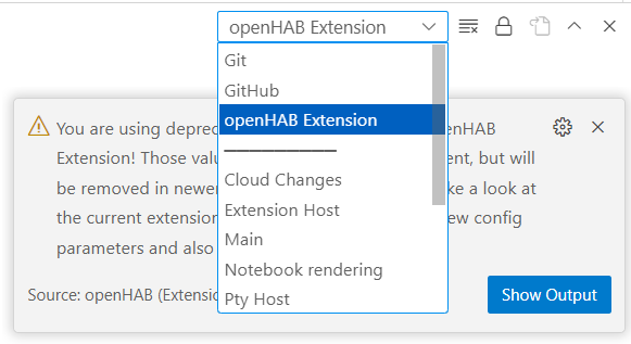

My initial reaction was “so what”, but then it turns out, the openHAB Language Server is no longer in the dropdown menu (which I assume means it’s not being loaded):

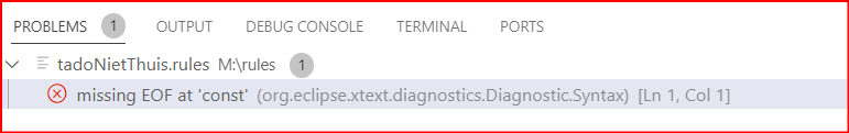

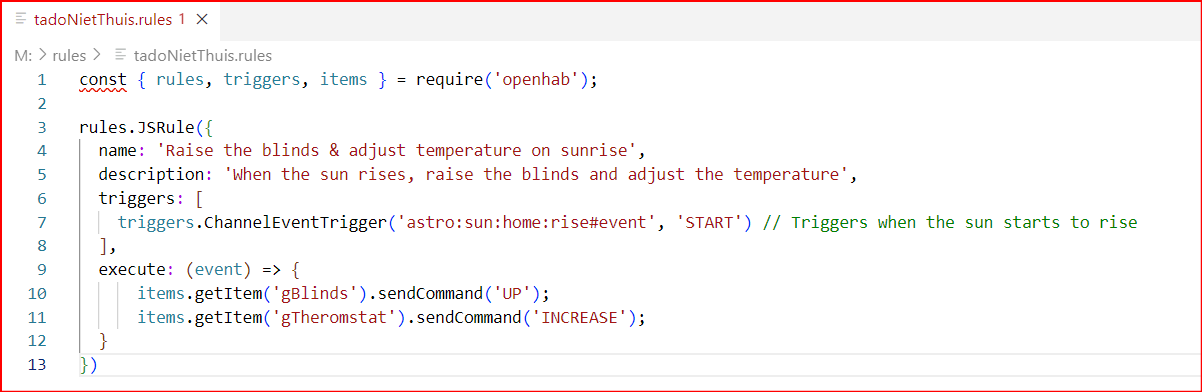

But without openHAB Language Server (I at least assume that’s the missing piece), there’s no visualisation of the code (for example: “rules.JSRULe” is not in colors, as I would expect it):
(I also don’t understand what’s supposed to be wrong with line 1, but that’s another matter (or is it because openHAB Language Server isn’t loaded?):

Yet, I get the same error message you do on the console, but I can see the openHAB Language Server option in the dropdown menu.
Although, I’m not sure if your problem with the rules is because only DSL is supported:
