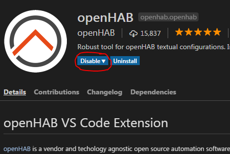

I also struggled with the Rest API connection. It was possible or get a connection to an openHAB server running on a Synology NAS, but I couldn’t connect to a local openHAB server running on Windows7. What helped me was to disable => reload => enable => reload in the openHAB VS code extension dialog:
After doing so, I suddenly could connect also to the local openHAB server running on Windodws.

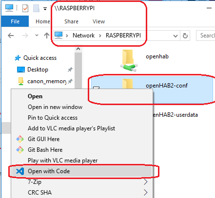

However, you must right-click on the conf folder and select “Open with Code”.
