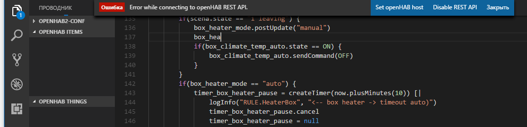

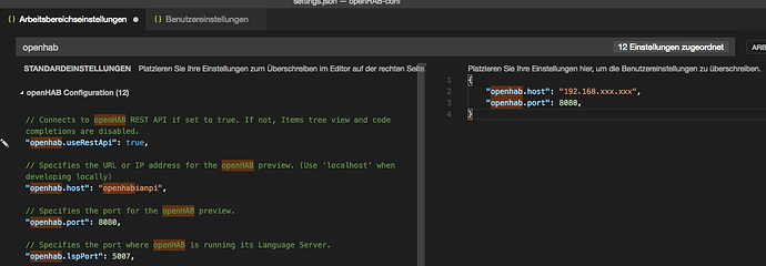

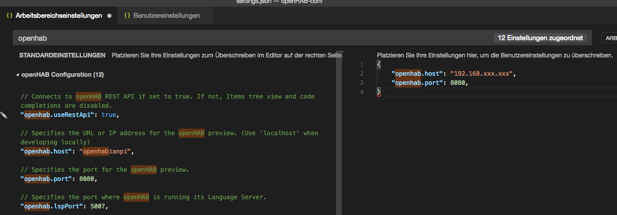

now i want to connect with the REST API - i changed:
“Arbeitsbereicheinstellungen” & " Benutzereinstellungen"
( Workspace-Setting / User-Setting )
to something like this:
   "openhab.host": "openhabianpi.local",
   "openhab.port": 8080
also tried with IP:
But what is the Username and Password ? - i always get the same error:
Error while connecting to openHAB REST API.
thanks

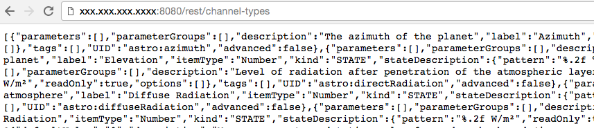

yes, openhab is running and i can see something in http://xxx.xxx.xxx.xxx:8080/rest
but still the same error

Workspace-Config:
You can try forcing the rest API by setting that value to TRUE. Or to FALSE to disable and get rid of the warning.
Also, did you add “Http://” to the front of your 192.168.xx address?

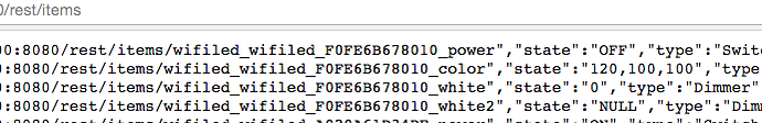

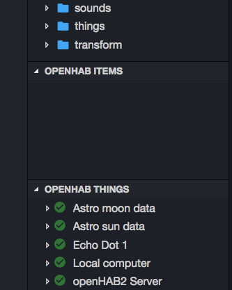

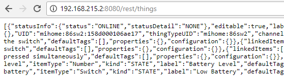

Hmm, could you go to xxx.xxx.xxx.xxx:8080/rest/items and tell if it’s returning anything?
I see that you’ve loaded Things successfully so I assume there’s something wrong with the Items.
Also, what’s your distro number?
my /rest/items result:
its the stable 2.1 version
openhabian - 7.05.170509
openHAB 2.1.0-1 (Release Build)

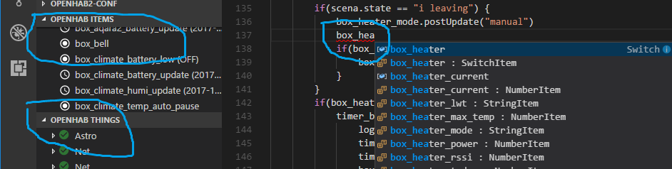

i got it working!
i deleted those items (bottom), saved and clicked on the OPENHAB ITEMS refresh-button ( in VSC ) - then i got the correct Items in VSC - strange…
(pasted the code for items back and saved again, still working )

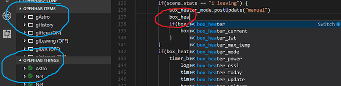

works :slight_smile:
workstation - windows 10x64 (1709)
openHAB2 - Ubuntu 16.04.3 server
openHAB 2.2.0 Build #1120

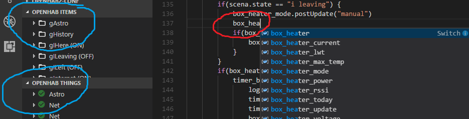

Снимок экрана (17)
I have 4 servers openHAB, I would like to work with the settings of the workspace. Help me to solve this problem.
Thank you!
its broken again, same settings… :frowning: buggy thing…
